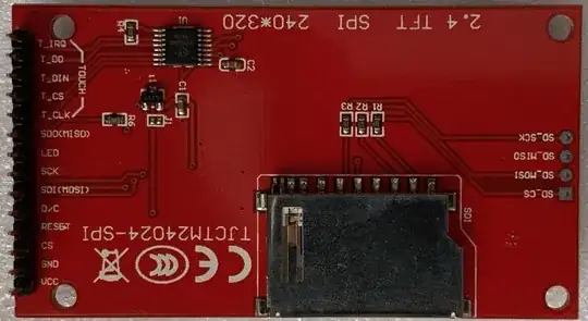

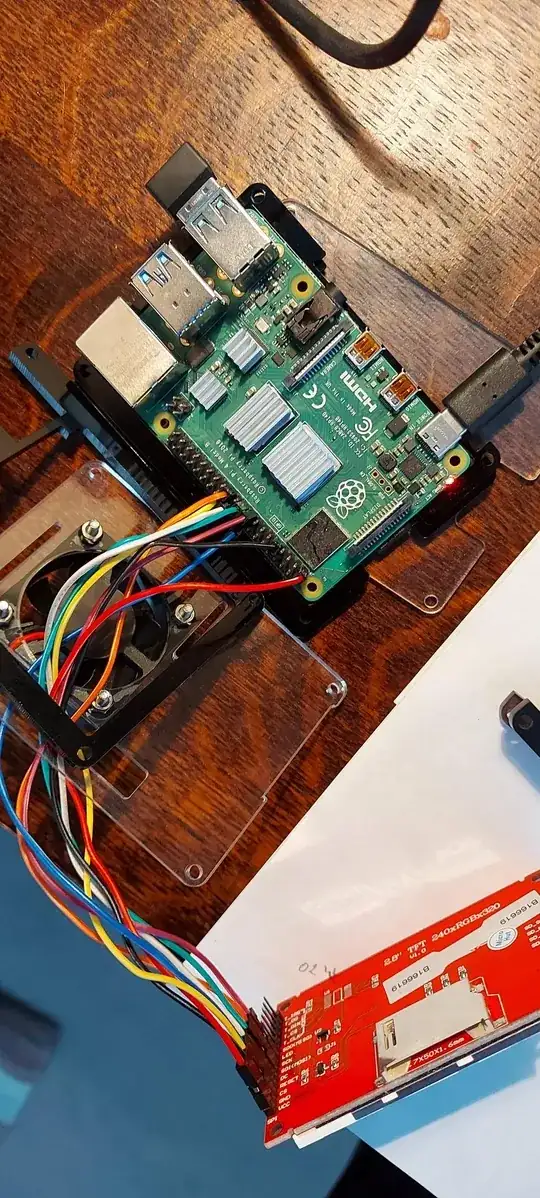

I've played around with a similar display (see picture below) the last days, maybe this will help.
I connected the Pi4 and the display based on the following article: https://www.xgadget.de/anleitung/2-2-spi-display-ili9341-am-raspberry-betreiben
This resulted in the following wiring:
2.4 TFT SPI 240*320     Raspberry Pi 4      Pin Nr
SDO(MISO)               GPIO 9 (MISO)       21
LED                     GPIO 18 (PCM_CLK    12
SCK                     GPIO 11 (SCLK)      23
SDI(MOSI)               GPIO 10 (MOSI)      19
D/C                     GPIO 24             18
RESET                   GPIO 25             22
CS                      GPIO 8 (CEO)        24
GND                     Ground              9 or 14
VCC                     3V3 Power           1 or 17
After that I only had to make the following adjustment (found on https://lallafa.de/blog/2015/03/fbtft-setup-on-modern-raspbian/):
sudo nano /boot/config.txt
--> add the following line to the end of the file: dtoverlay=rpi-display
After reboot, the console (Text) was visible on the display.
