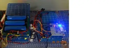

Appendix A - My GPS module blinking - YouTube
GPS Module Blinking
Appendix B - My GPS module setup
GPS module setup

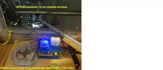

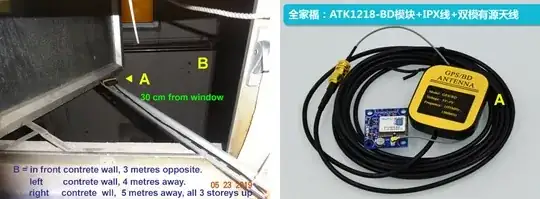

Appendix C - My GPS Antenna setup
GPS Antenna setup
Fix times 2019may23hkt2100 - first fix = 8 minutes, followed by 14 sec, 24 sec, 25 sec, 1.24 min, 1.13 min, then 17 min no fix, end of fixing test.

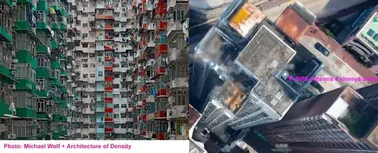

Appendix D - GPS Antenna Location - 4 stories down the "well"
GPS location

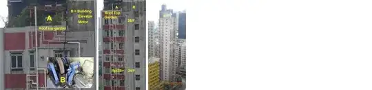

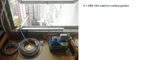

Appendix D - GPS Fix Time Measurement at Rooftop Garden
I am going to test if GPS fixing is possible with huge motor generated EMI around.
GPS Fixed Time Measurement at Rooftop Garden with huge EMI motor nearby

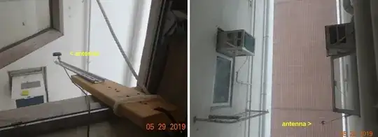

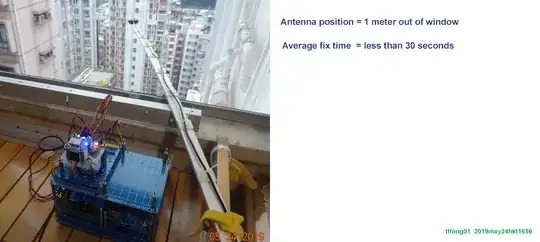

Appendix E - GPS Fix Time Measurement with Antenna 1 metre out of window
I surprising found that even with the antenna just 1 meter out of the window, the fix time is regularly less than 1 minute. My quick and dirty conclusion is that it not necessary at all to try any fix at the rooftop garden, ... :)
window 1 meter GPS fix test

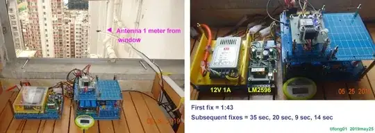

Appendix F - 200VAC in 12V AC out switching PSU performance
I read that the power supply for GPS module should be very stable. So I used LiPo 11.2V power bank with heavy duty 2.5A 5V voltage regulator for testing. This morning I used a weak 200VAC in 12V 1A PSU and light LM2596 regulator to test again. I found fixing times very good: 1m43s, 35s, 20s, 9s, 14s.
My quick and dirty conclusion is that the PSU quality doen't mater much. So from now on I will forget using LiPo battery bank and just use 200VAC in 12V out switching PSU.
using switching psu

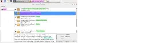

Appendix F - Downloading gpsd
gpsd download

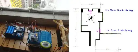

Appendix G - Fix time measurements by the window L corner, 0 cm from window
Now I am measuring fix time with antenna by the window very near to a L shape corner. I find average fix time around 5 minutes. So far so good. I am using 200VAC in, 12V DC out, regulated by LM2596 regulator and found no problem. So I will not be using any LiPo power bank in the coming tests.
fix time l corner

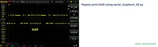

Appendix L - Testing Rpi built in UART serial loopback and repeat send char
The repeat send char 0x55 TxD waveform
rpi serial repeat send char 0x55

Appendix P - GPS/BD Antenna positioning and 15 metre RS232 cable testing
I found that it is not necessary to place the antenna to far out of the window, 15 cm can already get a good fix. So it is laughable that earlier I prepared a 3 meter long rod in order to position the antenna as far as possible from the window, because I read so many experience users and experts saying that PSU must be very very stable, must open sky etc etc. All the info I read does not apply at my geographical position and GPS module. I guess I need to check out a not GPS/BD, but GPS only, perhaps Neo-xM module to compare and contrast, to see if I still can get a good fix.
fix test 15 cm
