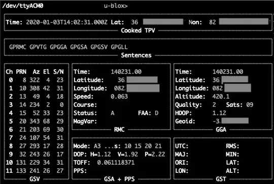

Running gpsmon - everything looks good to me. With 9 satellites at the moment.
gpsmon output

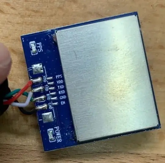

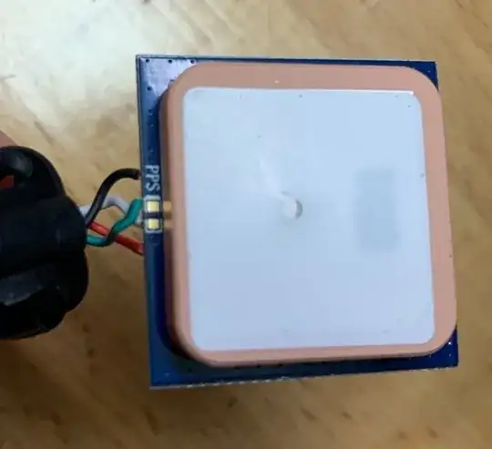

I'm unable to determine why the offset is so large. I'm also unsure why the PPS feature is not being exposed through the USB. After opening up the receiver, it appears to have a wire for it, but I can't read it. Also, I'm not great with electrical, so perhaps I'm also wrong.

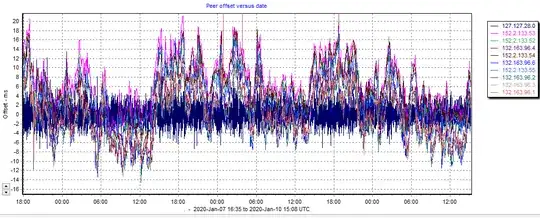

I came up with the value 0.070 after a lot of monitoring. First, I ran ntpq -c rv -pn often to view the offset over several hours. You can also run watch -n 30 ntpq -c rv -pn to automatically run it every 30 seconds. This gave me nice feedback and I was able to get a close offset quickly - however, I ended up with 0.080 using this method.
For the more accurate 0.070 value, I needed more a in-depth view of the offset over the course of an entire day. I enabled stats logging by uncommenting this line (debian buster default config already has stats configured correctly, it just needs this one line to be enable to go into effect):
statsdir /var/log/ntpstats/
That will cause two types of stats to be logged, loopstats and peerstats. I let it run for an entire day without modification or rebooting. After the day was complete, I exported the logs to a windows machine and downloaded a tool called NTP Plotter. With NTP plotter, I was able to generate graphs of my GPS offset vs. the public stratum 1 servers. In the graphs, I noticed I was consistently off and changed the time1 value to 0.070. After another full day of stats I repeated the process and was pleased with the offsets:
stratum 1 vs GPS offsets
As you can see in the graph above, my GPS offset stays roughly in the center now compared with the public stratum 1 servers I was using for testing.
Again, I do not understand why I need this offset, perhaps it has to do with delays with the USB and raspberry pi. But setting the time1 value solved it and I'm pleased that I was able to use statistics over a full day to be able to make an educated decision about the time1 value instead of just trial and error. I'm marking this as the solution for now, but if anyone comes up with a better method then I would be happy to change the solution.
