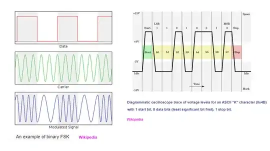

I guess the software minimodem, like the hardware modem, has the following signal specifications.
FSK (Frequency Shift Keying)
FSK is a signal consisting two frequencies, "mark" frequency denoting "1", and "space" frequency denoting "0". The modem uses FSK signals to talk to the telephone exchange.
RS232/UART
When two modems are connected, they talk using serial signals, such as 9600 baud, no parity, 1 stop bit.
I guess, for software modems, the input may be in WAV format, but the contents is still FSK or UART, not audio signals.
In other words, minimodem is never designed to output audio signals.
