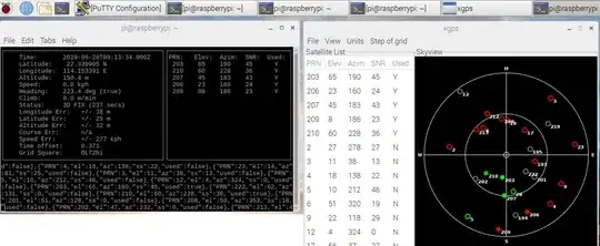

cgps and xgps run smoothly after installed the 6 packages below. All $path stuff are already automatically taken care of without newbies noticing anything.
gps_cgps_xgps
Perhaps you forgot to install some libraries.

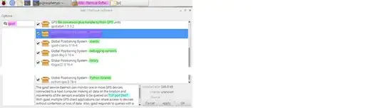

This afternoon I happened to also install GPSD. I am a GUI guy, don't know nothing about terminal commands, not to mention the newbie scary $path. What I did was click, click, click, and tick, tick, tick, ...
  1. From GUI Desktop > Install Software > Search "gpsd".
  2. Tick all the GPSD stuff that looks useful.
  3. Click OK.
  4. Day is done, no tears! :)
