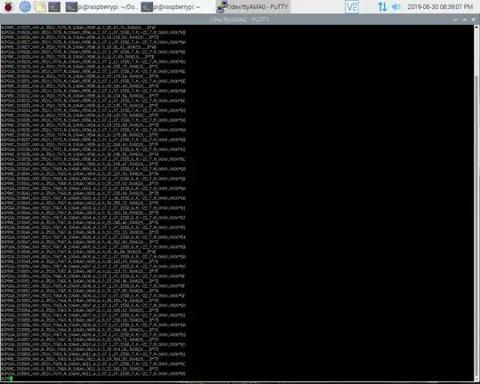

I then opened up Putty and using a 9600 serial connection to /dev/ttyAMA0 I see indeed that only GPGGA and GPRMC are being processed out:

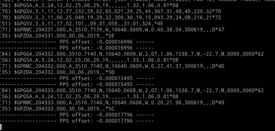

BUT...as soon as I reopen gpsmon/gpsd, all the NMEA message streams are reactivated'...what the heck ??
If I don't open gpsd/gpsmon...indeed only GPGGA and GPRMC are active.
