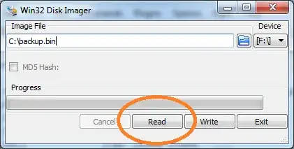

On Windows, you can use the reverse process that you used when flashing the SD card.

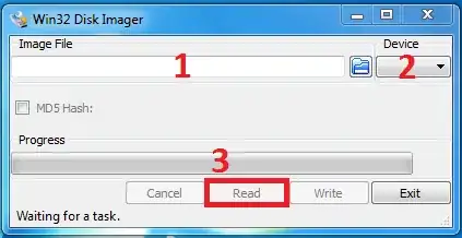

You can use Win32 Disk Imager, which is the preferred tool for flashing a SD card of the Foundation. Just enter the filename (the location and name of the backup image file to be saved), select the device (the SD card) and press read:
Win32 Disk Imager
Of course, you can also use RawWrite, dd for Windows or similar tools, the process is quite similar.

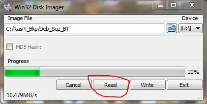

If you are using Windows:
  1. Download Win32 Disk Imager.
  2. Create the file path you wish to use to save your image. (I use C:\RasPi_Bkp)
  3. Run Win32 Disk Imager
  4. Browse to your backup file path spot, and type a file name.
  5. Click save
  6. Make sure the device shown in the drop down to the right of your file path is the one you want to back up.
Win32 Disk imager in Action
  1. Click "Read"
  2. Wait.
