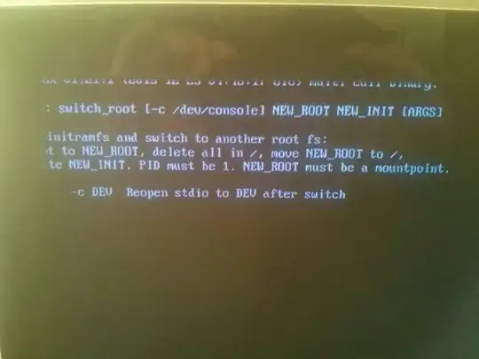

but i see nothing in Finder. booting off the card i get the coloured splash screen and then this pic of pi output
any ideas on how i can achieve what i need?

Try
sudo dd if=/Users/jon.england/Desktop/RaspBMC\ Backup/raspbmc.img of=/dev/rdisk1 bs=1m
You are trying to restore to /dev/rdisk1s1 which is the boot partition of the SD and only 70MB are being transferred.
You should also unmount the SD card first.
You would probably be better using SDFormatter.app
something is wrong with your image, because it seems too small -- 70 MB:
73400320 bytes transferred
it seems very unlikely the 4GB (or 2GB) SD card image becomes this small without compression, and even then, 1)it's still too small and 2)requires decompression of some sort.
and, finally, you're supposed to transfer the contents of /dev/disk1, not the single partition, that is /dev/disk1s1 -- only then you'll have the full backup image, as opposed to now, when you have only small part of it.
