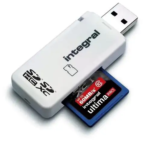

2. Keeping a spare SD card will provide you with additional options when you find yourself in this situation.
For example, if you want/need to recover files from your troublesome SD card, or if you want to do a post-mortem to discover where you went wrong. With a USB adapter-thing-y (as shown below), you can be restored -literally- in a minute or two:
Imagine: If you maintained a backup on this spare SD card, and you ran into this problem, you could do this:
  1. sudo shutdown
  2. swap the spare/backup SD card for the damaged one in your RPi, and
  3. reboot
You could have resolved this problem in far less time than we've taken posting and answering this question!
