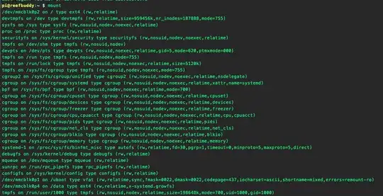

If it helps I created a backup disk image as was suggested here
Output from mount after reformatting the sd card and reflashing with the backup image.

You really should have stopped following the guide when you saw you had a different number of partitions. The guide above assumes that your root file system is on the second partition. Was that the case? The steps you took made the the data in every partition inaccessible, except the first two, and if your root partition was elsewhere, the system will no longer boot.
You can recover the data by recreating the partition table manually (you have all the numbers you need in your screenshot), or by restoring your backup. In both cases, you will need to plug the SD card into a computer which boots correctly, as the SD card is unbootable until you fix it.

As suggested in the comments I think you have overwritten the exiting filesystem. I would restore the sd card from the backup image.
When you log back in, issue the following commands:
sudo su raspi-config
In the menu that appears use the arrow keys to move down to selct select item 7 Advanced options. In the next menu select item A1 Expand Filesystem
That will expand the filesystem to the whole sd card automagically.
