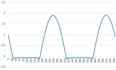

  2. Now, I've connected a function generator, sending out +/-2V amplitude of analog sine wave signal, to the waveshare board.
  3. By modifying the sample code provided, I've printed out the converted data and ploted them, which is the figure shown below (y-axis = voltage, x-axis = number of data)
  • figure 1: sine wave plot
Here are the questions:
  1. Is this normal phenomenon for this ADC board?

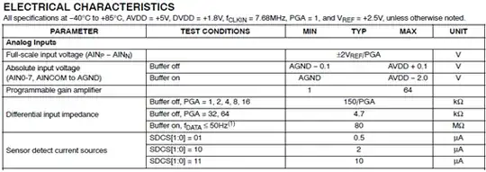

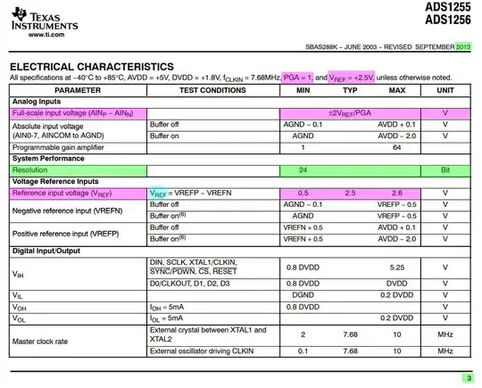

  2. If so, am I correct to assume that this ADC can only receive analog inputs above zero? (I've looked through the ADS1256 datasheet and studied a bit, but had hard time understanding the input range found in the document, shown below.)
  3. If above assumption is true, then can the analog input range be changed?
  • figure 2: datasheet screenshots, page 2 and page 3

Your ADC isn't working because you're exceeding the ABSOLUTE MAXIMUM RATINGS listed in your question:
Analog inputs to AGND: −0.3 to AVDD + 0.3 (V)
In other words, this ADC cannot measure negative voltages. Most simple ADCs can't do that.

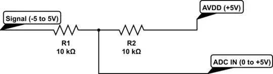

You could overcome the problem by adding a constant offset voltage to your signal (google "Non-Inverting Summing Amplifier"), then subtract this known offset from the ADC measurement in software. Or, if electronics is not your strong side, you could simply put the signal through a resistor divider attached to AVDD: a 2x divider will let you measure voltage from +AVDD to -AVDD:
schematic
Well, the datasheet says the analog input range is + - (Vref * 2) / PGA. In other words, if you set Vref = +2.5V, PGA = 1, then the input range is +-5V.
Though you can input +-5V, what is measured depends on Vrefp and Vrefn, as described in the overview.
