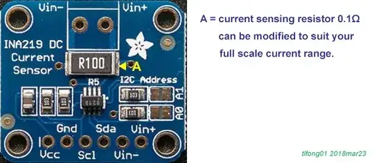

The only one I have been able to find, is the INA219, but it can only handle up to 3.2A, which leads me to ask two questions:
  • Can I solder another .1 Ohm resistor in parallel to the shunt resistor on board, to increase the max current to 6.4A?

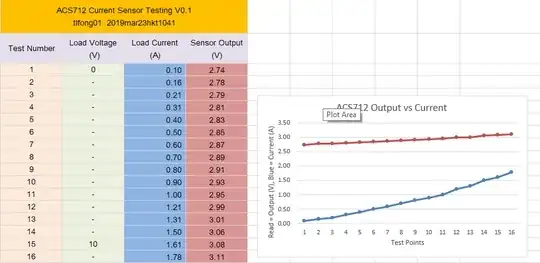

I don't understand what do you mean by "fluctuating" readings. Fluctuating by how much? 10% or 30%? Fluctuating how frequent? 10 times or 30 times per second?
I checked the datasheet and find that the total accuracy is 1.5%. In other words, any fluctuation within 1.5% is within specification.

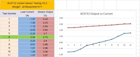

I checked the sensor voltage output vs current input, as displayed below. I found performance more or less linear. Next is to check current in reverse direction, to see how symmetrical is the sensor. PS - I did not observe any noticeable fluctuation as you reported.

Now I swapped the two connecting wires at the ACS712 current input terminal, and repeated the input current vs output voltage calibration. I tested the current range from -1.5A to 0A. The result is displayed below. So far so good. I am not keen to extend the test range to 5A, because I will only measure current for 12V DC motor, which takes less than 1A.
Now let me calculate the sensitivity.
V = 3.07V - 2.42V = 0.65V I = 1.57A - (-1.57A) = 3.14A
Sensitivity = V/I = 0.65V / 3.14A = 250mV/A.
Comparing with the datasheet's maximum sensitivity of 190mV/A, I concluded my ACS712 Sample #1 looks good.
I think I can consider this current sensing part more or less completed, and move on to the second part of OP's question - ADC, using MCP3008 or others.

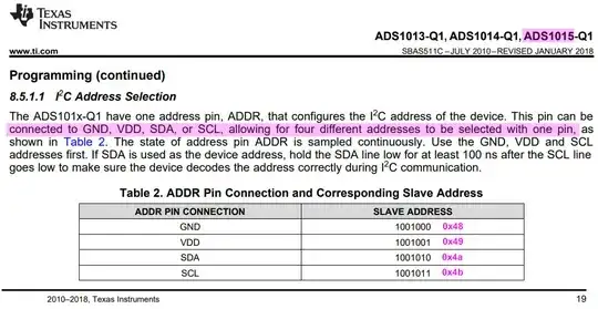

As I said earlier, it is very difficult to program Rpi to communicate through USB. The other options are UART, SPI, and I2C. UART is not comman nowadays, except perhaps in BlueTooth. SPI is easier than I2C, but not that many modules are available. For example, SPI MCP3008/3204/3208 ADC modules are not common and very expensive. On the other hand, I2C ADCs such as ADS1115, HX711 are common and cheap. I2C is harder to play with than SPI. For example, I am now trying to put 4 ADS1115 on one I2C bus, I found the module's 10k pullups are overloading Rpi's built 1k8, and I need to remove all the ADS1115 modules' pullups, otherwise the modules cannot be detected by I2C tools i2cdetect -y 1. Newbies might find desoldering SMDs a bit scary!

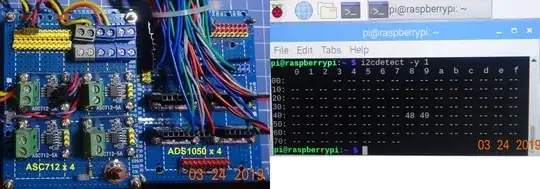

Assembling and testing the quad ADS1150 ADC Board
So I placed 4 ADC1150 on a 7x10cm protoboard. Now each of the 4 ADS1150 can be separately detected by i2cdetect -y 1 when ADDR set to 0x048, 0x49, 0x4a, and 0x4b. But at most two ADS1150 can be detected at the same time, even though I removed all the 10k pullups of each board. I guess the reason is I am using very long, over 60cm wires and so the resultant total capacitance overloads the TSX0104 logical level converter.
Next is to see if the ADS1150 ADCs can convert ASC712 current sensing outputs.

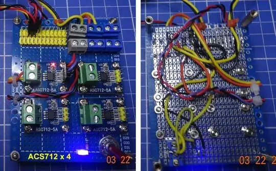

Why testing 4 current sensors and 4 ADCs at the same time

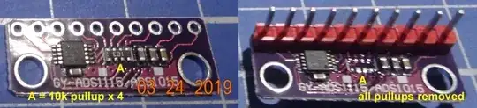

I am testing 4 current sensors and 4 ADCs at the same time, because I2C circuits are often intermittently reliable, so I can swap 4 identical circuits to find out which bad guy is causing trouble. I even have three TSX0104 based level shifted I2C channels to do swap troubleshooting. You may like to read the following thread for more details.

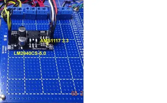

While calculating the biasing resistor for the KA431 reference voltage to calibrate the ADC ADS1150, I suddenly remembered that ACS712 does not have internal analog voltage like ADS1150, and no external analog reference input like MCP3x0y. In other words, it only uses Vcc as the reference. No wonder earlier I found the no current centre point of 2.75V, instead of 2.50V as expected. The centre point is actually not offset by 0.25V, but because the Vcc was 2.75 x 2 = 5.5V! So I now know I need to use a precisely adjusted voltage supply for the current sensor. I searched my junk box and found a mini psu with fixed voltages LM2940-5.0 for 5V and AMS1117 3.3 for 3V3.
I mounted the PSU on a protoboard and input 5V to ACS712. Then I found Vcc = 4.99V and the no current voltage is 2.49V! In other words the ACS712 centre point accuracy is (4.99V/2 - 2.49V) / 2.5V ~= 0.2%. So now I guess the OP says his readings are fluctuating, perhaps his PSU is not stable, or noisely fluctuating.
Now I think I can also use the AMS1117 3.3 output as the voltage standard to calibrate the ADC, instead of wasting time wiring the KAxxx voltage reference.

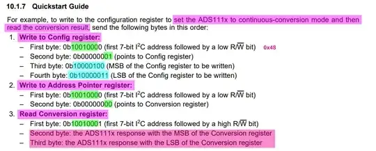

Now finally the time has come to program Rpi to check if ADS1050 ADC can accurately convert the voltage standard signal 3V3, output by AMS1117 3.3.
The first newbie program I am going to write is as suggested by the quick start guide in the datasheet, as pasted below. As usual, first thing first is try to read a register, second is writing something to a register and read back. This is usually the bottleneck, and may take me at least one day,

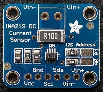

The INA219 does not have a maximum measured current, only a maximum measured voltage (26V). I suspect you've run afoul of this annoying recent trend of naming a breakout board the same as the IC it is breaking out.
To be clear, this is what an INA219 looks like:
And this is what a popular INA219 breakout from Adafruit looks like (the actual INA219 is below the "R5" designator):
So to answer your most important question, yes you can definitely modify the sense resistor to change the maximum measured current. When modifying the sensor resistor, make sure:
  1. you use a high precision (low percentage) and low thermal coefficient resistor. This is typically what makes a resistor, a "sense" resistor;
  2. you do not exceed the INA219's maximum voltage;
  3. you do not exceed the power rating of the sensor resistor - to find the power absorbed by the resistor, multiply the resistance by the maximum current squared. Eg. if you put a 0.1Ω resistor in parallel and half the 6.4A is flowing through it, it must be rated at at least 0.1 * 3.2 * 3.2 = 1W. Note the power rating will not be as good if the resistors are stacked on top of each other.
It seems to me that modifying the sense resistor is the fastest road to success you have available to you.
