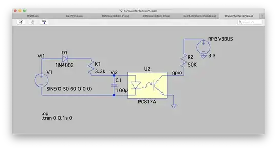

Interface schematic
But we can answer questions about interfacing a 50 VAC to your RPi. Here's a simple schematic that should do the job. This circuit converts a 50VAC signal to an active-low GPIO input:
opto-coupler interface to 50VAC
Some notes on the schematic:
  1. None of the components in the schematic are critical - that is, there are numerous parts that will work instead of the part numbers shown.
  2. D1 acts as a half-wave rectifier to convert the AC signal to a DC signal.
  3. R1 & C1 act in tandem as a low-pass filter (remove some ripple), and R1 limits the input current to the the opto-isolator's LED to a safe value.
  4. The opto-isolator's LED injects current into the Base of the NPN photo-transistor, causing current to flow from its collector to its emitter - as do all (most) opto-isolators.
  5. A pullup resistor is connected between the RPi 3V3 bus and the collector terminal of the opto-isolator. One may use the GPIO's internal pullup by configuring it in their code, or use an external pullup.
Analysis of circuit
To help you understand how this works, several graphs are shown below depicting some of the voltages and currents in the circuit. Note that this is a transient analysis performed in LTSpice, and you're seeing the circuit responses starting at t=0 - the time at which the switch (reed switch?) closes and connects the 50VAC to the interface circuit:
LTSpice transient responses
Some notes re the graphs from top to bottom:
TOP:
Green is the 50VAC signal showing a range of -50V to +50V
Red is the current flowing through the diode D1
MID:
Green-ish is the voltage at C1 (Vi2) - the voltage across the LED in the opto-coupler
Purple-ish is the current flowing into the LED in the opto-coupler
BOT:
The trace here shows the signal that can be fed to the GPIO pin you choose. The 50K pullup resistor is assumed to be an internal pullup - so you'll need to verify that the GPIO pin you choose as the input is configured properly.

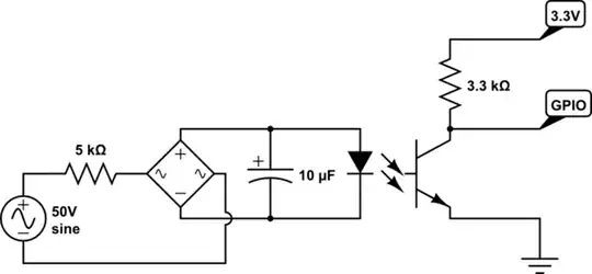

You have been told this is an EE question but some problems; opto isolators/ LEDs have a very low reverse rating (6V) and need protection.
You will have a 50/60Hz pulsed output which needs filtering.
Both of these can be minimised with a bridge.
I would use something like the following with a 4N28 opto isolator as a generic AC detector.
The values shown are not critical, but should be safe for 50V.
schematic
There are more serious safety concerns about the original with mains potentials which would not apply to 50V.
