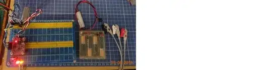

AD8232 on battery
I don't use the 3.5mm plug and long wire. I keep the wires out to the AD8232 very short by directly connecting to the duPont male header.
ad8232 short wiring

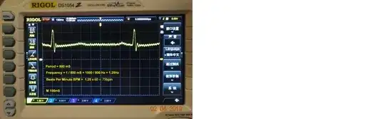

You might like to look at the AD8232 ECG of my own faint heart. :)
my ecg

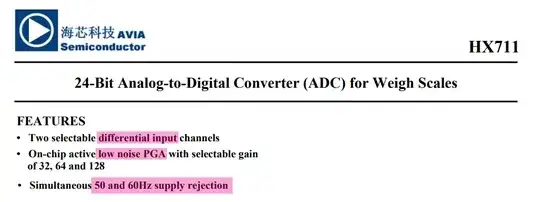

Before I move on, you might like to skim the posts referred at the bottom, where I discussed the noise problem using the very old SPI 10/12 bit MCP3x0y, ACS712/723, INA219/221, and how I have been trying to solve the problem using new type of low noise I2C/SPI 16/24 ADCs using HX711, ADS1025/1115, ADS1256, ...
You might notice that the new generation of ADCs almost always say their chip is very low noise, mains noise rejection, and selectable gain (to adjust the full scale for low resolution loss).
hx711

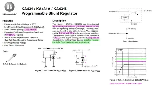

And if you are using MCP300x or MCP3204, do not use Vcc or resistor divided Vcc as the Vref, because Vcc is noisy. Use a good Vref chip such as KA431.
ka431

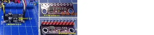

And it is a good idea to use a dedicated PSU, with adequate by pass caps, placed near the ADC. This way you can use this rather stable PSU as voltage reference, in case you do not want to use a zener or volt ref chip.
psu for adc
