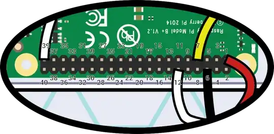

I am testing out this new birthday present I got ages ago and I this set I have got has got male pins and the raspberry pi's GPIO pins are male as well and they obviously appear to not go in.
This diagram explains what the issue is enter image description here
all of the wires going in are males and the numbered GPIO pins in the raspberry pi are all male as well

The (obvious) answer would be to get female to female cables. I usually keep all three types of sets M-to-F, F-to-F, and M-to-M handy. eg.
https://www.amazon.com/EDGELEC-Breadboard-Optional-Assorted-Multicolored/dp/B07GD2BWPY

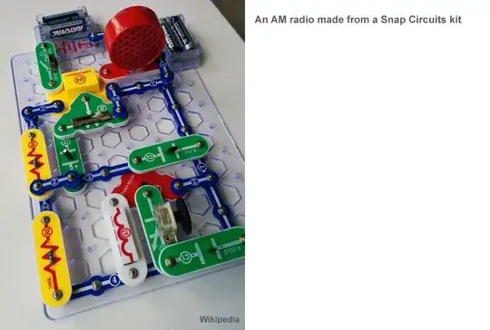

Snap Circuits - Wikipedia
Snap Circuits is a line of electronic kits manufactured by Elenco Electronics and aimed at children eight years and older.
The kits come in a variety of sizes, offering a range of building experience for the user, and may include motors, lamps and speakers. The kits consist of a breadboard with prewired interconnections, into which the various components can be snapped to easily create a working circuit.
Snap Circuits has been praised for exposing young children to elementary engineering concepts.
snap circuit

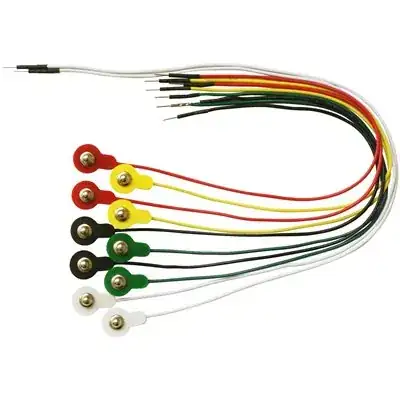

Button Wire for Snap Circuits
AliExpress 40 pieces Dupont 2.54mm Female to Female 20cm 1P-1P Jumper Wire - US$1
