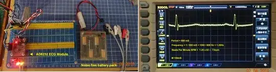

ad8232 setup
You may like to read the references to get a very rough idea of how Rpi controls the AD8232 ECG chip.
Warning to Rpi and electronics newbies learning the AD8232 ECG module
ECG signal is analog and often has big noise problems as mentioned in the referenced post below. Newbies for sure find things difficult. You may need a small team of basic Rpi hardware and software beginners to do a long term, say at least three months to one year (depending on your background) to complete a college level group project. You also need a US$300 digital storage oscilloscope to help displaying signals (especially the nose signals).
