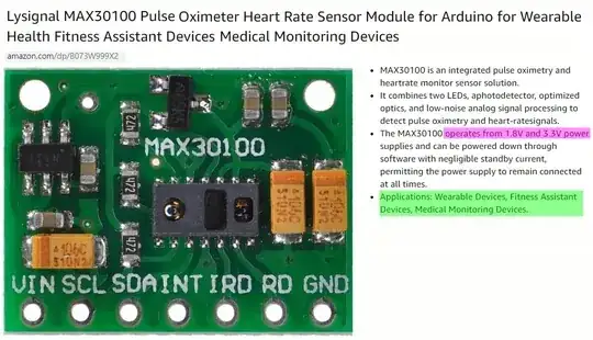

The OP has setup and successfully detected an I2C MAX30100 Pulse Oximeter and Heart-Rate Sensor module. But when trying to read the sensor, he encounters two problems:
(1) Gets the "Exception remote I/O error [error 121]",
(2) Gets only zero values for the red LED and IR Led outputs.
How to fix it?

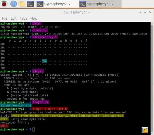

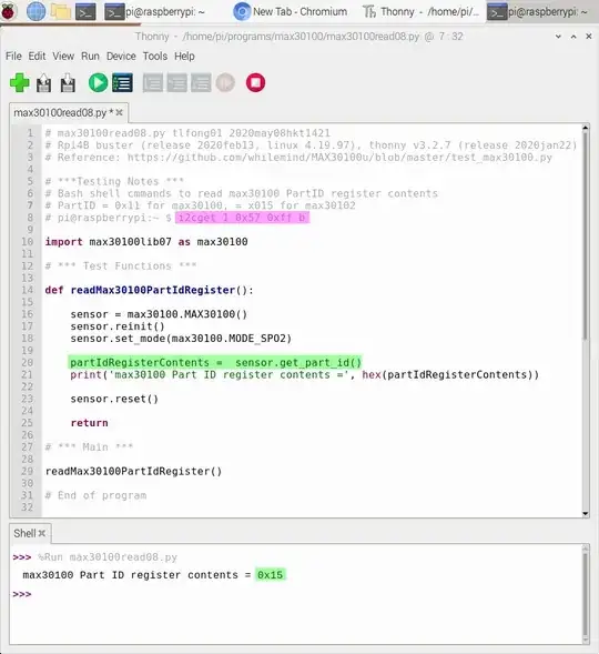

(1) Suggest to check I2C wiring and use "i2cdetect" and "i2cget" to find max30100 chip at I2C Bus #1, I2C device address 0x57, and Part ID 0x11 or 0x15 at max30100 register address 0xFF, as show below. (Note: MAX30100 Part ID is 0x11, MAX30102 is 0x15)
max30100 read

(3) Using max30100's library methods to read PartID register OK.
read part id reg

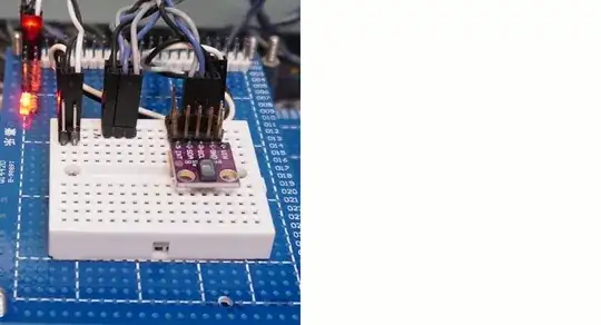

(1) Hardware Setup
hardware setup

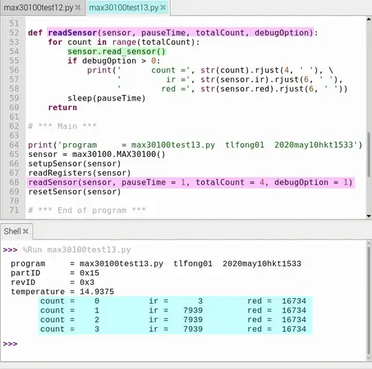

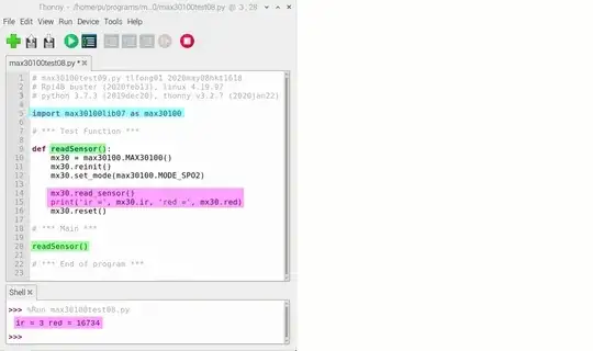

(2) The simplest read sensor program
read sensor v09

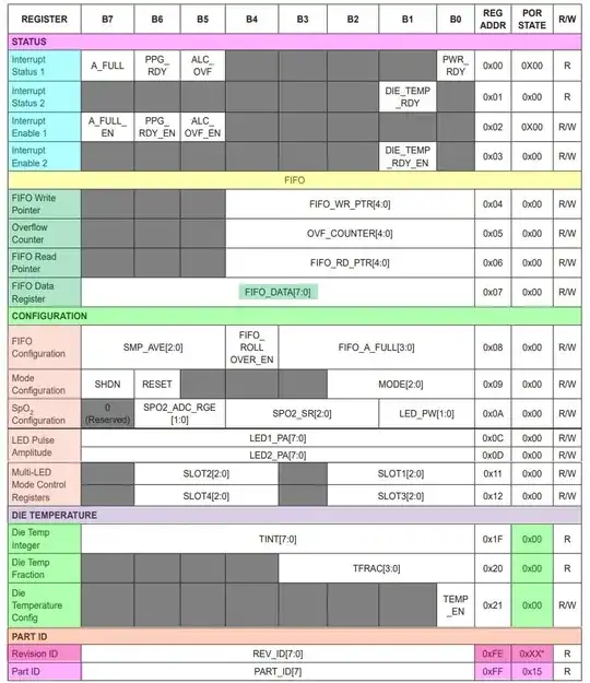

(3) Minimal program to read registers and sensor
Sample Output
partID = 0x15
revID = 0x3
temperature = 14.9375
ir = 3 red = 1
ir = 3 red = 1
ir = 3 red = 1
ir = 3 red = 1

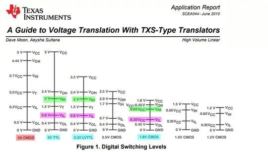

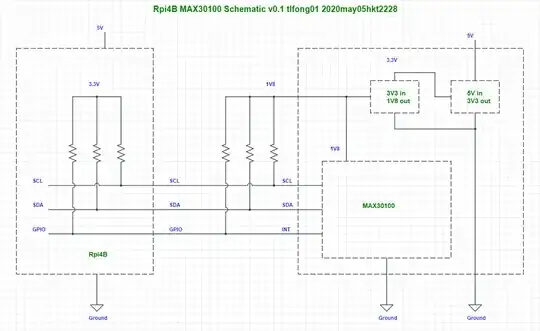

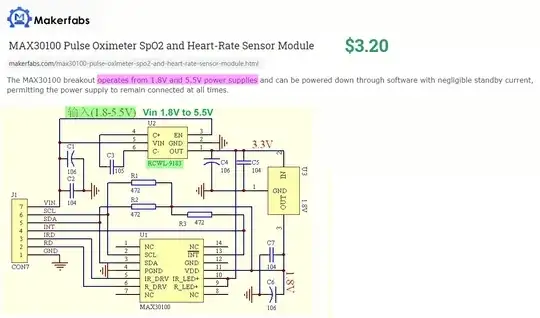

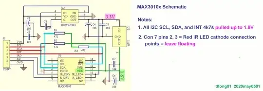

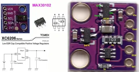

(4) What sort of power supply should be used for the MAX30102 Board?
When I first read the MAX30100 board schematic, I was confused about the 6 pin component marked in Chinese "Input 1.8V to 5.5V". I googled around and found users claiming different things, from the board is wrong, to how to removed the 4k7 pullup resistor external to the board and connect them to 2.8V or 3.3V. It is only after I figured out why there is a 6 pin voltage regulator then I realize what should I do, like (1) Should removed the 4k7s out and connect to 2.8V, or 3.3V, or even 5V, if I am stepping up Rpi I2C signals from 3V3 to 5V, ...

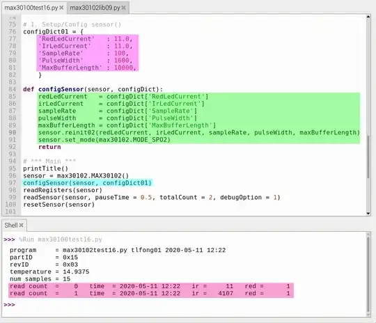

(6) Measurement performance of variable values of LED current, pulse width, sample rate etc.
variable parameter performance

Appendix A - MAX30100 Test Program v13 - Repeat reading Sensor
test13
# max30100test13.py tlfong01 2020may10hkt1502
# Rpi4B buster (r2020feb13), linux 4.19.97
# python 3.7.3 (r2019dec20) thonny v3.2.7 (r2020jan22)
*** Import ***
from time import sleep import max30100lib07 as max30100
#*** Setup / Configuration ***
sensor1 = max30100.MAX30100()
*** Test Functions ***
Contents
1. Setup sensor()
2. Reset senor()
3. Read registeres()
4. Read sensor()
5. Repet read sensors()
1. Setup sensor()
def setupSensor(sensor): sensor.reinit() sensor.set_mode(max30100.MODE_SPO2) return
2. Reset senor()
def resetSensor(sensor): sensor.reset() return
Read PartID, RevID, temperature
def readRegisters(sensor):
# *** Read PartId *** partId = sensor.get_part_id() print('partID =', hex(partId))
 # *** Read Rev Id ***
revId =  sensor.get_rev_id()
print('revID       =', hex(revId))
# *** Read Temperature ***
temperature =  sensor.get_temperature()
print('temperature =', temperature)
return
def readSensor(sensor, pauseTime, totalCount, debugOption): for count in range(totalCount): sensor.read_sensor() if debugOption > 0: print(' count =', str(count).rjust(4, ' '),
' ir =', str(sensor.ir).rjust(6, ' '), ' red =', str(sensor.red).rjust(6, ' ')) sleep(pauseTime) return
*** Main ***
print('program = max30100test13.py tlfong01 2020may10hkt1533') sensor = max30100.MAX30100() setupSensor(sensor) readRegisters(sensor) readSensor(sensor, pauseTime = 1, totalCount = 4, debugOption = 1) resetSensor(sensor)
*** End of program ***

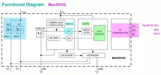

Fig 1 - MAX3010x System Diagram
max30100 system
Fig 2 - MAX3010x Function Diagram
max30100 function diagram

Fig 4 - GY-MAX30102 Module Schematic
max30100 schematic
Fig 5 - GY-MAX00 ProductSheet
max30100 product sheet

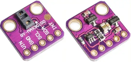

Fig 6 - GY-MAX30100 PCB Components Layout Diagram
max30100 pcb

Fig 8 - MAX30102 PCB and Components Layout
max30102

(1) read_max30100.py tlfong01 2020may05hkt1936
# read_max30100.py tlfong01 2020may05hkt1936
# Rpi4B buster (release 2020feb13, linux 4.19.97), thonny v3.2.7 (release 2020jan22)
# Reference: https://github.com/whilemind/MAX30100u/blob/master/test_max30100.py
import max30100
def readMax30100PartIdRegister():
sensor.reinit()
partIdRegisterContents =  sensor.get_part_id()
# partIdRegisterContents = 'fakeFakeFake'
print('max30100 Part ID register contents =', partIdRegisterContents)
sensor.reset()
return
*** Main ***
End of program

return
*** Main ***
if name == 'main': main()
*** End of Program ***
(3) Measuring Performance of adjusted values of LED current, sample rate, pulse width
# max30100test16.py tlfong01 2020may11hkt1141
*** Import ***
import inspect from time import sleep from datetime import datetime import max30102lib09 as max30102
title = 'max30102test16.py'
sensor1 = max30102.MAX30102()
*** System Functions ***
def printTitle(): print('program =', title, 'tlfong01', str(datetime.now())[0:16]) return
def byteNumTo4Char(byteNum): tempStr = ((hex(byteNum))[2:]) if (len(tempStr) != 2): tempStr = '0' + tempStr fourCharStr = '0x' + tempStr return fourCharStr
Contents
1. Setup sensor()
2. Reset senor()
4. Read sensor()
2. Reset senor()
print('revID       =', byteNumTo4Char(revId))
sensor.refresh_temperature()
# *** Read
numSamples = sensor.get_number_of_samples()
print('num samples =', numSamples)
return
def readSensor(sensor, pauseTime, totalCount, debugOption): for count in range(totalCount): sensor.read_sensor() if debugOption > 0: print('read count =', str(count).rjust(4, ' '),
' time =', str(datetime.now())[0:16],
1. Setup/Config sensor()
configDict01 = { 'RedLedCurrent' : 11.0, 'IrLedCurrent' : 11.0, 'SampleRate' : 100, 'PulseWidth' : 1600, 'MaxBufferLength' : 10000,
def configSensor(sensor, configDict): redLedCurrent = configDict['RedLedCurrent'] irLedCurrent = configDict['IrLedCurrent'] sampleRate = configDict['SampleRate'] pulseWidth = configDict['PulseWidth']
maxBufferLength = configDict['MaxBufferLength'] sensor.reinit02(redLedCurrent, irLedCurrent, sampleRate, pulseWidth, maxBufferLength) sensor.set_mode(max30102.MODE_SPO2) return
*** Main ***
printTitle() sensor = max30102.MAX30102() configSensor(sensor, configDict01) readRegisters(sensor) readSensor(sensor, pauseTime = 0.5, totalCount = 2, debugOption = 1) resetSensor(sensor)
