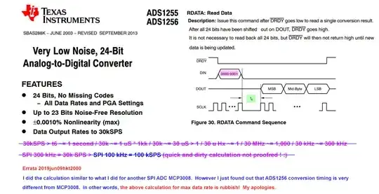

ADS1256 data rate calculation

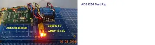

Now I am connecting Rpi to the ADS1256 Module
ads1256_connect
ads1256 wiring
ADS1256 Test Rig
ads1256 test rig 1

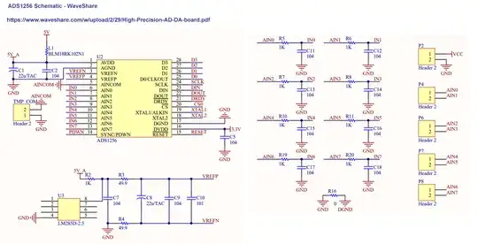

(9) WaveShare ADS1250 ADC Module Schematic

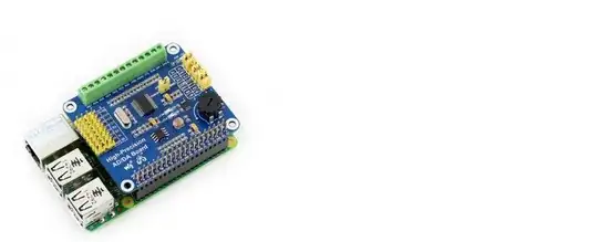

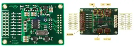

Appendix A - WaveShare ADS1256 ADC Module Picture
waveshare adc
Appendix B - WaveShare ADS1256 ADC Module Schematic
Waveshare adc schematic

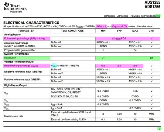

Appendix C - ADS1256 Characteristics
ads1256 char

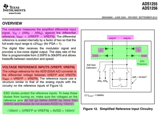

Appendix D - ADS1256 Overview
ads1256 overview

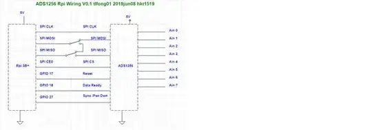

Appendix E - ADS1256 Connection Diagram
ads1256 connection diagram

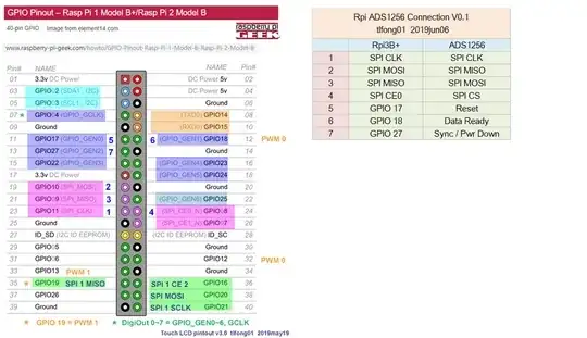

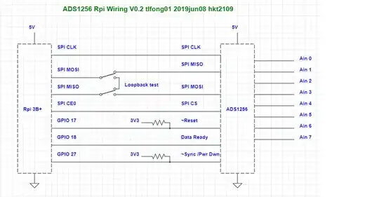

Appendix F - Rpi3B+ ADS1256 Wiring V0.2
Circuit URL
rpi ads1526 wiring

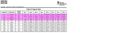

Appendix G - ADS1256 Register Map
reg map

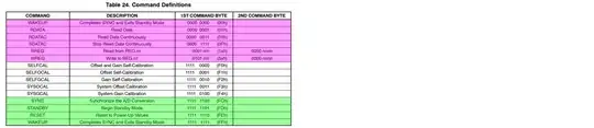

Appendix H - Commands
commands

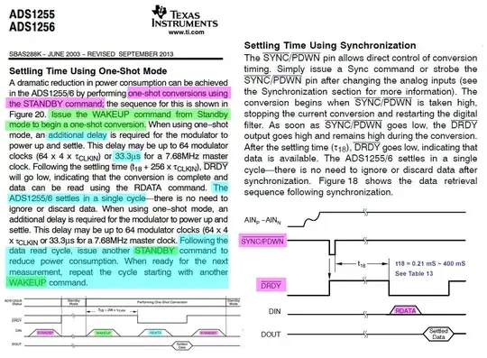

Appendix I - One shot mode ADC
For one short mode of standby-wakeUp-readData, the wake up delay is only 33.3 uS.
one short mode ADC

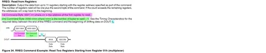

Appendix J - Write Register and Read Register
wreg
rreg

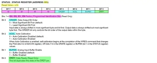

Appendix K - Status Register 0x00
status reg
Appendix L - SPI Loopback test (before testing ADS1256)
Now I am doing a SPI loopback test as a preparation to read and write ADS1256 ADC registers.
