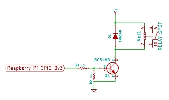

Why not simply like this?
Raspberry Pi switches between 0 and 3V3, more than enough to saturate Q1, which takes over the "heavy" work: switching the +5V relay on/off. Depending on the relays you're using, small modifications for D1 and Q1 might apply.

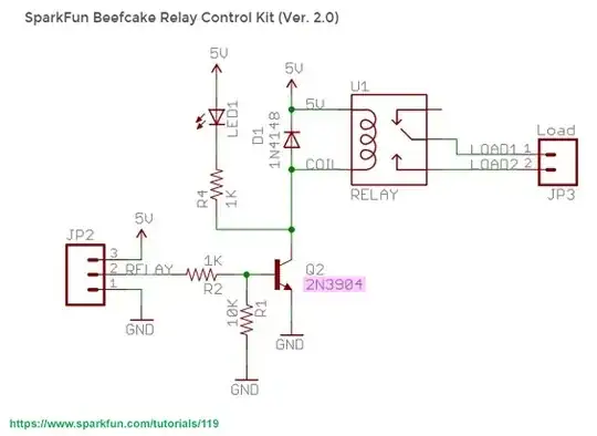

The Sparkfun's Beefcake relay module has an NPN transistor 2N3904 (Q2) driving the coil (U1). It is designed for Arduino's 5V logic signals.
SparkFun relay control kit schematic

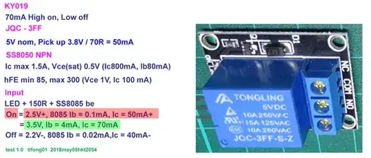

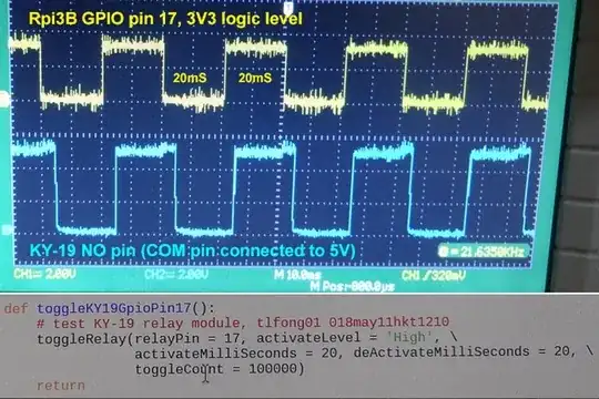

I have a similar NPN transistor module KY019 which can be driven by Rpi's 3.3V signals. So I checked out its input signal requirements to find why KY019 can entertain 3.3V signals but Beecake can't.
KY019 spec

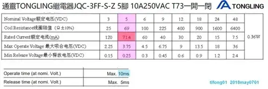

I found that KY-019 has a trigger level of 2.5V and 0.1mA. This signal is amplified by the NPN transistor to 50mA, high enough to engerize the coil to activate the relay.
Tongling coil spec
Rpi GPIO (with High level above 2.8V, and max current limit of 16mA), can comfortably source 4mA, there should be no problem directly driving the module.
The coil has a response time of 10mS. I programmed Rpi GPIO pin 17 to toggle the relay module at 40mS period (25cps) and found the relay clicking happily as expected. (I was using 2 meter long connecting wires for the GPIO signals, so the signal at at relay input end is a bit noisy.)
KY019 toggle test
How to modify the Beefcake module to make it compatible to 3.3V logic
The Beefcake NPN transistor has a current limiting resistor R2 of value 1K. This resistor limits the base current at Arduino 5V logic high level. The base current within limit, after amplification (usually hFE > 100), is big enough to engerize the coil.
Calculation of Arduino 5V GPIO current into Beefcake relay module:
Arduino current i ~ (4V [Arduino High] - 1V [Vce(sat)]) / 1K [R]) = 3V / 1K = 3mA
However, the Rpi's logic High signal is lower than Arduino, so the corresponding limited current is smaller and after amplification is not big enough to drive the coil.
Rpi current i ~ ((3V [Rpi High] - 1V) / 1K = 2mA
The modification is simple - just replace 1K R2 with a smaller resistor, say 510R.
Rpi current i (after modification) = (3V - 1V) / 501R = 4mA
I am making education guess based on circuit analysis and experimentation. I think my guess is 90% likely correct.

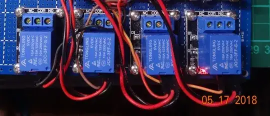

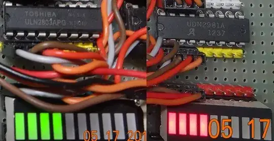

I first manually tested UDN2981, without connecting to Rpi, to blink 4 LEDs, to make sure the circuit is working OK.
uln2803 udn2981 photo

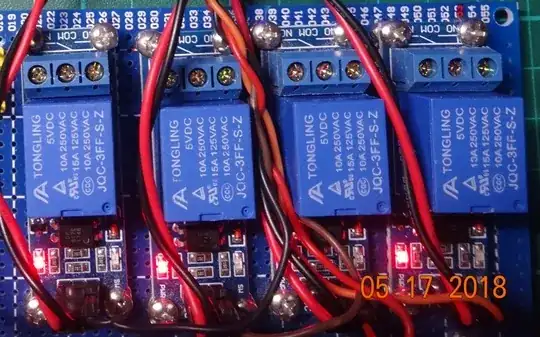

Then I setup 4 NPN transistor input type relay modules (KY019), and connected the 4 relay module inputs to 4 UDN2981 channel outputs.
KY019 x 4

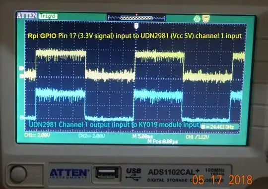

Then I connected 4 Rpi 3.3V GPIO pins directly to the 4 UDN2981 channel inputs. I used the following python function to toggle 4 relay modules at 25 cps.
python function to toggle 4 relays
The result was good. The 4 relay modules click and LEDs blink at 25cps as expected. The Rpi GPIO output signals stayed near 3.3V, and UDN output signals around 4.0V, implying that no input was overloaded.
Toggle module waveform

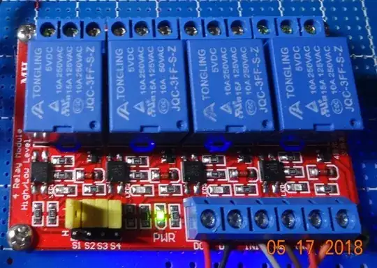

UDN2981 controlling High trigger, opto-isolated relay modules
The OP also considered using opto isolated relay modules because they are safer. I have successfully used the same UDN2981 to control 4 High level trigger, opto isolated relay modules (MK055).
MK055 relay modules

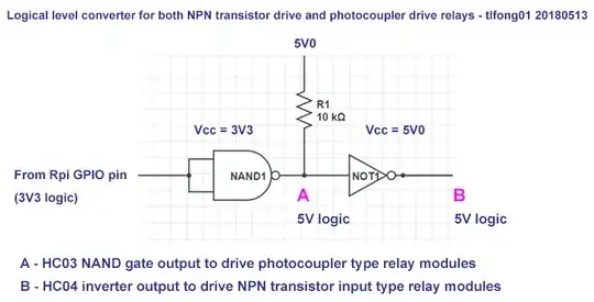

# Solution 3 - Using 74HC03 and 74HC04 to shift up RPi's 3.3V GPIO signal #
Using UDN2981 to drive a relay module is a big over kill, because they are designed with built in fly back diodes to directly energize relay.
The UDN2981 is not common and not for beginners to experiment. For beginners, the very common and cheap logic gate ICs, 74HC03 Quad NAND gates, and HC04 Hex Inverters can do the same job as UDN2981, shifiting up 3.3V logic signals.

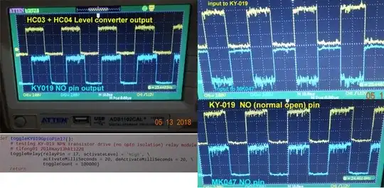

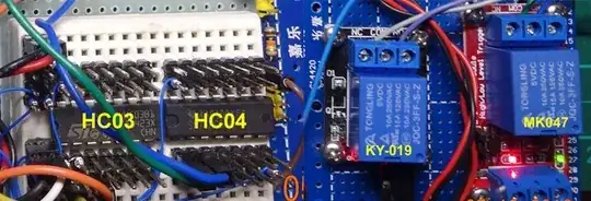

I have successfully verified HC03 and HC04 shifting up 3.3V logic to 5V and found it working for both transistor input and opto isolated high level trigger modules.
hc03 04 converter schematic
hc03 hc04 ky019 mk047
hc03 hc04 ky019 ky047

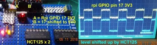

# A.3 Logical Level Converter using HCT125 #
So I tested another up converter, HCT125. I was happy to find that it works well. The HCT125 converted 5V0 signal did not drop when connected to the NPN transistor driven relay module.
HCT125 level converter

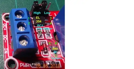

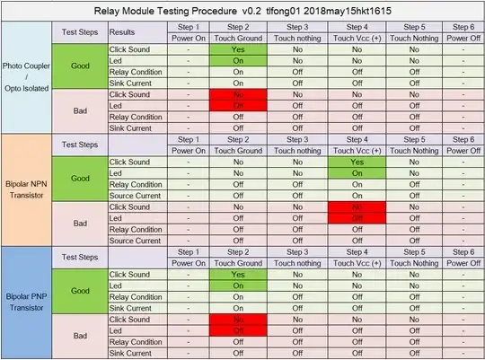

How to check Photo Coupler / Opto Isolated Relay Module
  1. Get a jumper wire.
  2. Connect one end to signal/input pin of relay module.
  3. Hold the other end and touch the Vcc(+) and Gnd(-) pin and check the results below.
Relay Module Test Results Table
2.1 Transistor input type
For the popular bipolar NPN transistor input type, the sourcing driver signal (Rpi GPIO signal or RPi GPIO signal after 3.3V to 5V logical level conversion) goes to the base of the transistor through a series LED and biasing resistor.
Example of transistor input type (BJT NPN) relay module
There are other not so popular relay switching circuit as described in this relay switching tutorial
2.2 Photocoupler input type
The photocoupler input type relay has a phtocoupler as the input. The photocoupler drives another transistor which in turn drives the relay coil.

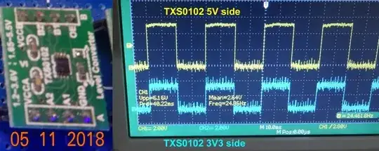

Appendix C - Logical level converter using TXS0102

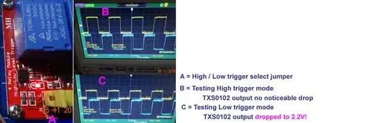

Now I know that Rpi GPIO can directly drive the relay module, but there are two problems. First, the GPIO signal with a long connecting wire is noisy, therefore not that reliable. Second, the flywheel diode 1N4148 might not completely suppress the coil back EMF, and if unluckily the 1N4148 breaks down, or not properly connected (poor contact, dry soldering joint etc), the back EMF might damage the Rpi.
So I decided to use a logical level converter to shift up the Rpi GPIO signal from 3V3 to 5V. I first tried TXS102 converter and found it working well. Besides shifting up the GPIO siganl, the noise at the high level is also greatly reduced.
TXs0102 photo and waveform

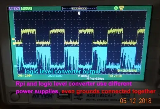

However, I found a big problem when feeding the converted 5V GPIO singal to the relay module. The relay still turned on and off as before, with the 3V3 signal, but when I used the scope to check out the waveform, I found the very surprisingly that 5V signal dropped by half, to 2.2V.
I suspected the reason was that TXS0102 can sink current much better than sourcing current to the relay module. To verify my guess, I fed the 5V signal to another relay module, a pull down photocoupler type, model MK01.
This time I found the 5V signal did not drop any noticeable amount.
So I quickly concluded that the NPN transistor type relay module is a bad choice. I would stop testing this kind of relays from now, and move on the photocoupler type of relays.
I also tested another photocoupler driver module MK101. This module has a jumper to select Higher trigger or Low trigger. I found that for Low trigger, the TSX0102 converted 5V signal level is not affected. But when Low trigger is selected, the converted 5V signal level dropped to around 2.5V, though the relay is still working.
txs0102 test high low trigger modules

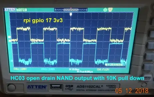

Appendix E - Logical level converter using HC04

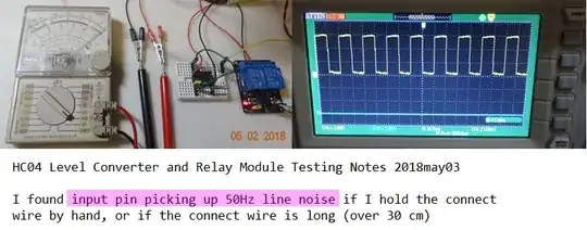

HCT125 is not so common. So I tried one more converter circuit, using HC03 quad open drain NAND gate and HC04 hex inverter. When I tested the HC04 output, I found it very noisy. I guessed one reason was that I was using dirrerent power supplies, one for rpi, another for the converter. Even I connected the ground points of the power supplies to make a common point, the noise did not go away. I then used one power supply for both rpi and converter, and the noise disappeared.
Noisy converter output
I tried the HC04 output signal for the relay module in Low trigger mode (which requires sinking current, but not in High trigger mode (which requires sourcing current), . So I am going to add the HC04 hex NOT gate which can source current to the relay module.
Appendix F - HC04 Level Converter Floating Input Problem
Last time when I first tried the HC03 based level converter, on a photocoupler relay module, I found that if I left the input floating, the module picked up the noise and the relay switched on and off crazily. I thought the frequency was perhaps 1kHz. I was not sure if it was some sort of positive feedback oscillation. But when I used the scope to check out, I surprisingly found it was 50Hz! I guess it is some sort of resonance. But I don't know what is the difference between resonance and oscillation. Perhaps I should goggle again. Anyway, I think I need to add a pull up/down resistor somewhere.
HC04 Level converter floating input problem

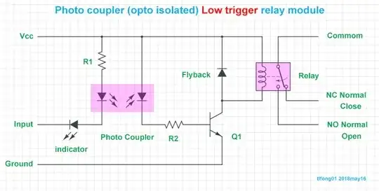

# A1. Opto isolated / Photo coupler relay module board and schematic #
Opto isolated relay module has a photo coupler which is 4 pin IC. The picture below shows a photoCoupler PC1 (with its 4 pins labelled 1, 2, 3, 4 in green) and a transistor Q1. The ICs are not always marked. In this picture, PC1 is EL354, and Q1 8050.
Photocoupler input type relay module photo
Photocoupler input relay module schematic
