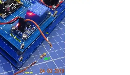

Solution 1 - Add a resistor at the input terminal
Short Answer
Add a 4k7 resistor at the IN terminal. Rpi should now switch on/off the relay without any problem. Yes, it is that simple. If 4k7 does not work, read the long answer below to find a value that works.
Add 4k7 to IN

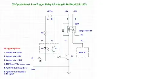

There are 5 methods to get around, and a schematic is helpful to explain.
Low trigger relay circuit analysis

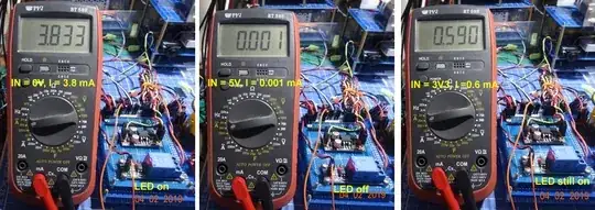

Now I am using a jumper wire to connect IN to the following voltage levels, (1) Ground, (2) 5V, (3) 3V3.
Green LED is on if IN = 0V (Gnd), off if IN = 5V. In other words, it 5V logic compatible.
Howeve, Green LED is still on if IN = 3V3. This means 3V3 is not high enough to switch off.
I checked that the IN current at 0V = 3.8mA, at 5V = 0.001mA, but at 3V3, current is still high, 0.6mA.
in signal = 0V, 5V, and 3V3
Now that for the fixed input values of oV, 3V3, and 5V, the currents are 3.8mA, 0.6mA, and 0.002mA, and corresponding status of relay are On, On, Off. To make the relay 3V3 logic or Rpi compatible, the 3V3 current should be so small to cut off the optocoupler and therefore relay off.

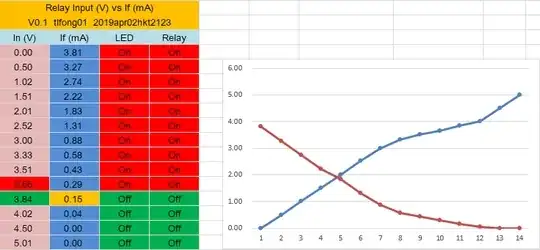

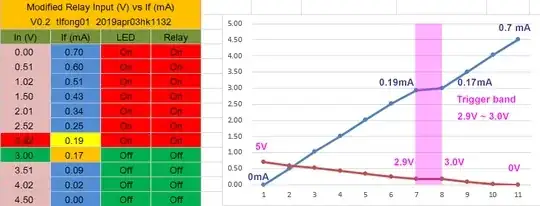

To look at the whole picture of the relay characteristics, I used a adjustable voltage power supply to check the If vs In voltage, and plot a graph as below. Now I can see the trigger point is < 3.62V (On) and > 3.84V (off).
I need to modify the circuit so that the trigger band shifts down to below 3V, Rpi's High signal value.
Relay optocoupler infrared LED current vs In signal
Actually it is very easy to shift the trigger band down to below 3V. The trick is to note that the corresponding trigger current is around 0.15mA (highlighted in orange). So just increase the current limiting resistor so that the current is below 0.15mA when Vin ~=3V (or 2.8V, to add a little bit of safety margin).
But if modified current limiting resistor too large, then photo transistor won't saturate. So I did a couple of trials and errors and found 4k7 seems a good choice. The engineering trade off / experimentation is selfied below.
Solution 1 - add 4k7 to IN terminal
Now I have checked the LED current vs Vin from 0V to 5V, to make sure that the trigger band is not too narrow to cause a stability problem. So far so good.
Next step is to use a python program to verify that Rpi GPIO ~3V/~0.5V High/Low signal can directly drive the modified 5V relay.
Modified (adding 4k7 to IN terminal) If vs Vin graph .

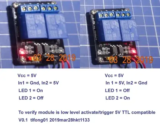

Luckily I found a similarly looking guy. First thing first is to check out if it is (1) low logic level activate/triggerable, and (2)5V Logic compatible.
Me no English, so I selfie!
To show module (1) low activate, (2) 5V logic

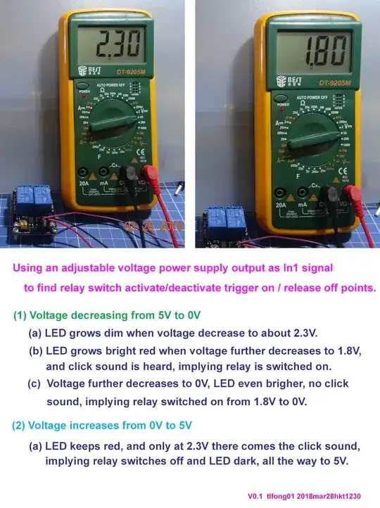

Now that I know the relay module switches on when In1 is Ground, and off when In1 is 5V, I move on to test (a) how high, say, 3V or 4V can still turn it off, and (b) how low, say, if 1V or 2V can still turn it off.
There you go, selfies again.
Finding relay activate/deactivate signal voltages
Earlier I though my module similar to the OP is not Rpi compatible either. But I surprising found that its trigger points are approximately 1.8V- and 2.4V+. Since Rpi's low level is < 1V, and high level > 2.8V, therefore Rpi has no problem switching it on/off. (Arduino high/low are approximately < 1V and > 4V, so also has no problem.)
So now I still need an example similar to the one OP has, to explain why Rpi's low signal is OK to switch it on, but Rpi's high signal is not high enough to to switch it off (without fiddling with the JD-Vcc jumper, which most newbies never heard of!). I searched my junk box again, and did similar engineering experimentation with the results below.

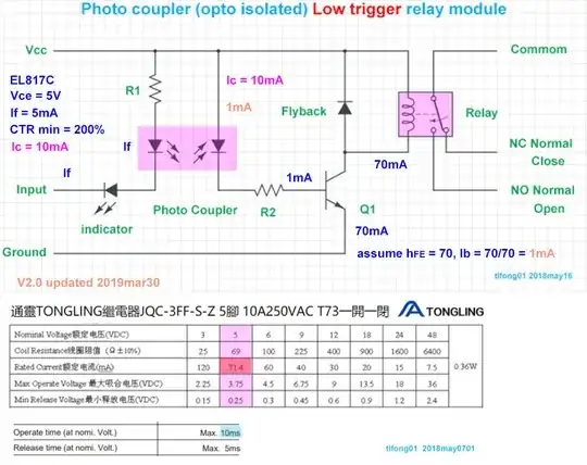

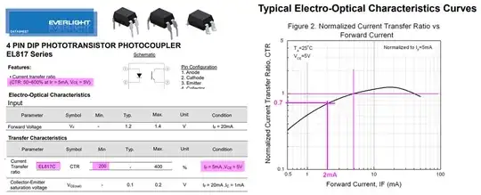

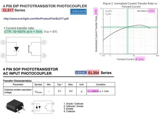

To answer the above questions, we need first to see how the photocoupler works. Here is the picture.
EL87C and EL354 Photocoupler summary notes
Now that we know the specification of the photocoupler, we can do some quick and dirty calculations, to make sure that the relay will not harm you rpi GPIO.

Low Trig Opto EL817C 5V Relay Rpi GPIO Input Current Requirement Calculation
Working backwards, Ic needs only 1mA. Working forward, If 5mA would generate 10mA Ic, fully saturate photo transistor. Conclusion - Rpi GPIO Low need only 5mA to fully saturated photo transistor.
The question is Rpi GPIO High too High to cut off photo transistor?

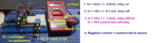

Now I am going to measure the current flowing into low level signal (power ground, or Rpi low). The objective is to check if current flowing into Rpi GPIO signal pin is too large to damage the Rpi. I am going to check two types of low level relays, (1) without optoisolation, (2) with optoisolation, similar to the OP's relay. The results shows that for this relay, signal current is between 0mA~4mA, safe enough for Rpi, but not compatible to Rpi, because Rpi High is not high enough to switch on this relay.

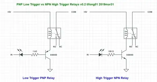

The second relay tested is low trigger PNP type relay, as shown on the left of the schematic below. One way to get around the Rpi high level signal is not high enough problem is to increase the series resistance, so that less current flows into the LED and therefore cannot drive the photo transistor into saturation.
Next to measure the current for OP's opto isolation type low trigger relay.
No opto isolation relay low signal current measurement

If If is only -2mA, I need to check the CTR at this point and see if Ic and Vce(sat) etc. So I checked out the CTR pic and found CTR at 2mA is 70%. So Ic is 2mA * 70% = 1.4mA, should be safe enough, ...
EL817C CTR at If = 5mA

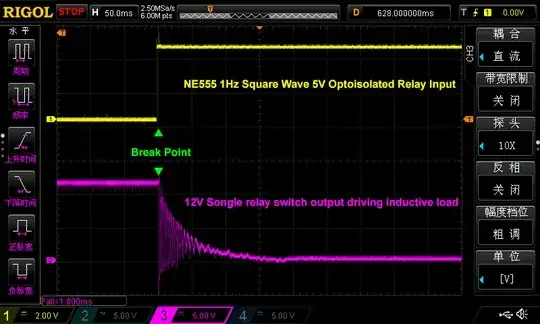

Youtube showing a NE555 timer 1Hz square wave, switching on/off a 5V Rpi incompatible, low level trigger, optoisolated Relay

Back EMF Check of Four Inductive Loads (Motor, Solenoid, Water Pump, Solenoid Valve)
youtube video of relay driving 4 inductive loads
Optoisolated Back EMF Voltage
Input signal seems almost completely optoisolated. Next is to compare relay WITHOUT optoisolater.
