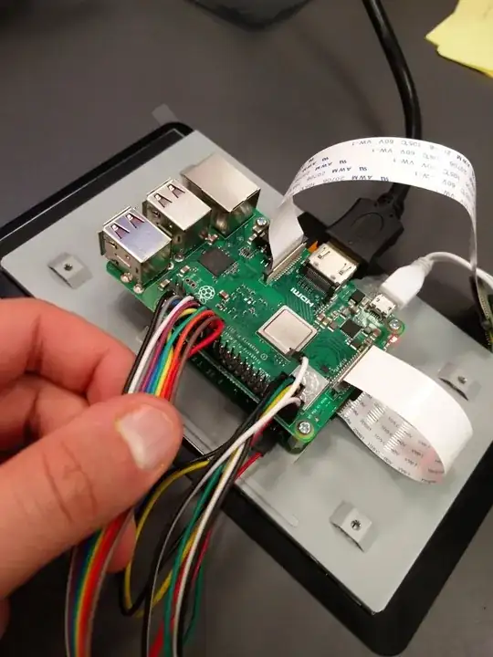

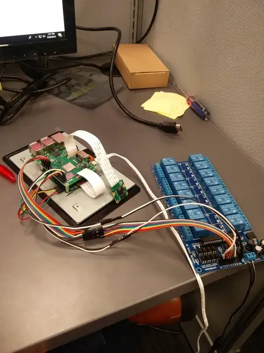

I am working on a project that requires a camera analyzing some images and activating the appropriate GPIOs to control a relay board. I currently have a touchscreen display, a Raspberry Pi Cam attached to the Raspberry Pi. I am trying to connect a 16 channel relay module to control some motors. Here is the specific relay module I am using

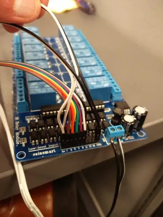

I looked at videos online about how to connect, however whenever I run it, nothing happens. The relay module has an external 12V power supply, which I connected. And I have connected all the GPIOs that I wanted to use from the Raspberry Pi to the relay board. In addition, I connected the 5V and 3.3V connections to the 2 5V pins on the relay module (I used the 3.3 because the other 5V is being used to power the touchscreen display). I have checked all the voltages and everything seems fine. Whenever I run the following code, nothing seems to happen:

Connections from Raspberry Pi
Connection to Relay
Overview Connections

The relay module you linked (which has limited documentation) states:-
12V 16-Channel Relay interface board, and each one needs 15-20mA Driver Current
The Pi GPIO can (safely) sink up to 16mA - and if using all relays would overload an Arduino, and probably the Pi.
Of course this assumes the Pi could even drive the opto-isolator, but if this has a series LED and resistor is unlikely.
Powering from 5V is dangerous and is likely to blow up the Pi.
The comments on the Amazon site indicate it is unsuitable for use with the Pi.
The Foundation even has a FAQ detailing the shortcomings.
As an aside there is absolutely NO POINT is using an opto-isolator with a relay! Any additional isolation they claim to supply is illusory if there is ANYcommon connection between the two. Opto-isolators have a low current transfer ratio - which just makes it harder for the Pi to drive.
There are a number of (poorly-designed) relay boards on the market - they MAY work with an Arduino, but are unsuitable for the Pi. (There are quite a few posts on this site discussing these.)
There ARE modules (without opto-isolators) designed to be driven by 3.3V logic levels which are suitable.
You could drive this from the Pi using a transistor (if you haven't already blown the Pi).

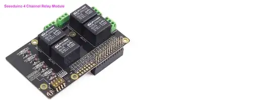

Appendix A - [Expensive/Industrial grade] Rpi Compatible 3V/5V Relays (US$15 ~ US$30)
PiFace Raspberry Pi Relay Board - £27
WaveShare Raspberry Pi Relay Board - $19
SeeedStudio Raspberry Pi Relay Board - $25
seeeduino relay
I2C Interface DockerPi Four Channel Relay Module - Seeed Studio - US$19

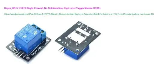

Appendix D - Cheapy Single Channel 5V Relay Modules for Poor Hobbyists (US$1)
For hobbyists and newbies, I would like to recommend the dirt cheap single channel, no optoisolation, high level trigger modules. Just now I googled "5v relay module raspberry pi" and found 200+ results.
Google search results for "5v relay module raspberry pi"
I found the Keyes KY019 relay module which I have tested OK for Rpi.
Keyes KY019 Single Channel 5V High Level Trigger Relay US$1 each
ky019 module
