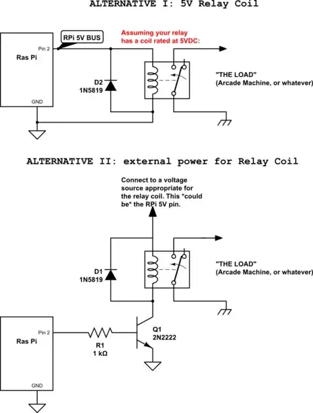

Do I need code or can I just simply attach to the GPIO 5v and ground?
Yes, you are spot on. No code is needed, and no "GPIO" pins needed. Note that the 5V bus is not a GPIO per se - 5V is available on pins 2 and 4 of the 40-pin header as shown here.
Assuming your relay has a coil that is rated for 5V simply connect the relay coil as shown in ALTERNATIVE I below. Here's how it works:
  1. When you power up your RPi, the 5V bus will be enabled. The 5V bus (pin 2 on the header) will in turn energize the relay coil, moving the contactor from the open terminal to the terminal connected to your "arcade". If wired correctly, this will turn on your arcade.
  2. D1 is necessary to protect the RPi from the inductive "kick" when the magnetic field in the coil collapses at turn-off time. D1 must be a Schottky diode. See also
If your relay coil is rated at more than 5VDC, the circuit at ALTERNATIVE II must be used.
  1. Q1 and R1 are necessary to "buffer" the RPi from the higher voltage, and switch current through the coil to operate the contacts. In this case, when the 5V bus comes up, it causes a small current to flow through R1 into the base of the transistor Q1. This in turn biases Q1 such that current may now flow unimpeded through the coil and Q1's C-E junction.
  2. Note that your "LOAD" (the arcade) need not be connected to the same ground that your RPi uses. In fact, the "LOAD" need not be DC at all - it could be an AC voltage. The coil and the contacts are said to be "galvanically isolated".
Here's how to wire this arrangement:
schematic
