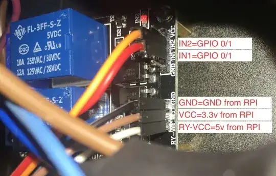

I connected my FL-3FF-S-Z two channel relay board to my Raspberry Pi 3, with gpio 0 and gpio 1 (numbers are from to $ gpio readall). Following some guide, as GPIO generates only 3.3v I have removed the jumper from RY-VCC/VCC pins and connected 5v to RY-VCC from the RPI and 3.3v to VCC from the RPI then connected the ground from RPI to the ground of the relay board.
I can switch the relay on and off with no issues without load. Both on as well as off switches the led on and off respectively and the relay makes the typical 'click' sound indicating the switch has indeed switched inside. This I have also checked with my digital multimetre and when no load then the relay just works fine.
The problem I have is when I put the mains on a relay's middle pin with the load on the Normally Open pin (so it is off by default) and switch the relay on from my RPI then it does switches on with the 'click' sound and led, and my load gets the mains, but then it cannot be switched off: The led goes away but no 'click' sound and the relay is still on as my load still gets the mains. Even if I remove the mains and fully unplug the relay board from my RPI (unplug all 5v/3.3v/ground/GPIOs) the relay is staying on for some time. I do not know for how long as cannot babysit it but this I have also checked with my digital multimetre. I do not know what causes it to switch back, probably a capacitor or something else gets slowly discharged.

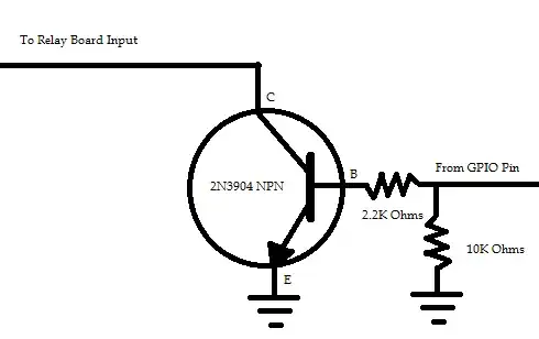

Have you experienced anything similar? Would an npn for each relay input (see below, source: this) address my issue and switch the relay on/off properly when it is instructed to do so? My relay is very similar to that one shown in below picture but has only 2 channels rather than 4.

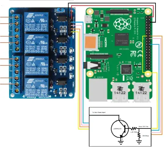

Added another picture with the Raspberry, Relay board and the additional circuit in question in order to make my question more understandable.
