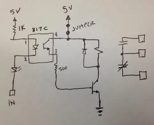

Considering the hand-drawn schematics available at the product page linked in the question, it is clear that the circuit is "active low". That is, the coil of the relays is energized if the input is low. The controlled contacts however are two-way contacts so that it is possible to either break or make a contact when either energizing or de-energizing the coil. If possible it is however advisable to chose the configuration in which the coil is energized the least amount of time.
(source: https://www.amazon.com/dp/B00KTEN3TM/ posted by Granpinos, Jul 06, 2015)

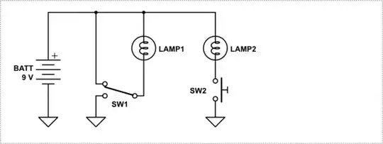

Here is how it works in simple terms.
Consider the following schematic.
Applying a LOW to a lamps turns it on.
It is sometimes referred to as "active low" signal.
schematic
