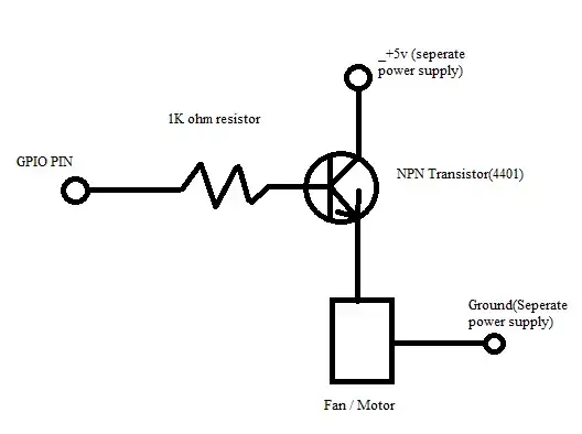

Since you're using BCM numbering, the pin you're using is the SCL pin (used for spi communications) and has a pull up resistor. This is a general warning. and is something I've encountered before, and I found out why here: http://www.raspberrypi.org/forums/viewtopic.php?f=32&t=96128. I've been able to ignore this warning in my projects. As for running a fan, you do NOT want to power the fan from the RPi +5v line, you'll risk damaging the pi, etc, as noted above. You should use a separate power supply for the fan, and use the gpio to switch it on / off. In the case of a 5v fan, a transistor would be able to act as a switch, but anything requiring a higher voltage, you would want to use a relay. I drew a simple schematic for you to control your fan, please forgive my ms paint skillz.....
I hope this helps :)
Peter
