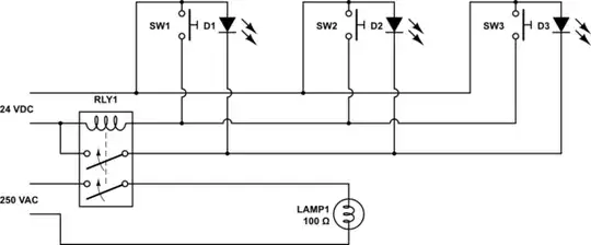

With regular switches, that would be tough, however, we already have a centralised, yet analogue system: Several dozens of low voltage push buttons with indicator leds are spread across the house. These are all physically wired to latching (bi-stable) relays in the central fuse box (this type). So with a short button push, a low voltage pulse is sent to the relay, which will make it flip state and holds that. Multiple buttons can be wired in parallel to the same relay. The relays are bi-polar, so that all corresponding indicator lights follow the state of the light.
schematic
To add automation on top of the existing functionality, I suppose we would need to replace the latching relays in the fusebox by a multi-relay raspberry pi system. It must be controlled both from HomeKit commands, as well as from physical push buttons. The relays would also have to bi-polar to control both the lights and the indicator leds.

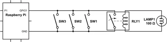

To me it seems a lot easier to connect the pi outside your existing relay - essentially making the pi work as just another switch in parallel with the other ones on the circuit you want to control.
This way you can use your existing bi-polar relay board.
schematic
This will save you the trouble of operating high-voltage circuits as well.

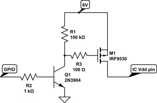

Assuming the relay uses a "high pulse trigger" as suggested by the added schematics in the question a high side switch is required to simulate this pulse with the Pi. This question at EE.SE shows how to do it. The node "6V" is replaced with your +24V, "GPIO" is your Pi's output pin, and the node "IC Vdd pin" goes to the relay in parallel with the push buttons - though I am pondering whether an additional diode in series is necessary to decouple this circuit from any feedback if the push buttons are pressed.
Source: https://electronics.stackexchange.com/a/90326/52154

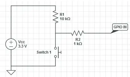

Reading back the status of the indicator LEDs could be as easy as placing a pull-up resistor in parallel to the LEDs (between the terminal of the relay and +24V), e.g. R1 = 47kOhm (higher than listed in the example due to the higher supply voltage), and connect via another resistor to the Pi's input GPIO pin (as pictured here).
Source: https://www.raspberrypi.org/learning/physical-computing-guide/pull_up_down/

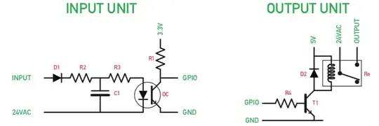

Thank you Bex and Ghanima for the suggestions. You motivated me to keep experimenting until it worked. The question got >1000 views so I better share my working design:
Correction: 24VAC
First a correction: The indicator leds and latching relays are actually on 24V alternating current. This added some extra complexity.
Input Circuit
To read the 24VAC signal that was meant for the indicator LED's, I used a diode and capacitor to rectify and smoothen somewhat. The resulting DC signal triggers an optocoupler which drives the GPIO input pin.
Output Circuit
To send pulses to the latching relays: The GPIO output pin drives a transistor, which creates enough current to trigger a small relay which can switch the 24VAC.
the input and output circuit
Galvanic
Thanks to the optocoupler and small relay, the microcontroller is galvanically isolated from the outside world.
