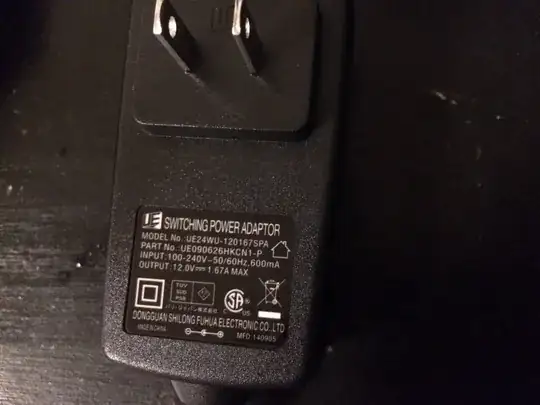

This is the adaptor:
Power adaptor

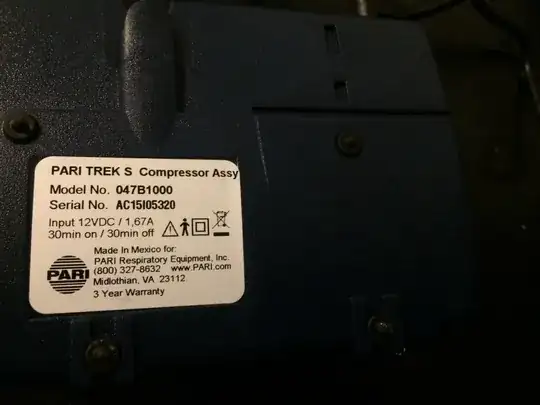

And this is the sticker on the compressor:
Power adaptor
Assuming I'm a programmer who knows nothing about electronics, how can I switch the power on or off using Python or preferably C on my Raspberry Pi?

You'll need just two things:
Make use of the GPIO pins
Using the GPIO port of the Pi is possible with numerous libraries for all significant languages. Finding one that interfaces well with Python or C is no trouble at all. Just have your pick, e.g.
Use a relay to control the 12V power line
A simple transistor is sufficient to drive a small relay from the Pi's GPIO pin. Just pick a relay that supports more than 2 A, but that should not be a big deal. Or go for one of the custom addon boards for the Pi, e.g. the PiFace.
Ghanima
  • 15,958
  • 65
For the relay just go to amazon and search (JBtek 4 Channel DC 5V Relay Module). It is $6 and a lot easier then trying to wire it up yourself. Also I would suggest (T Cobbler Plus 40 Pin GPIO Expansion) that way it easy to connect to the pi and if you pi dies you just plug in a new one.
