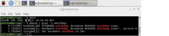

Once you have this configured and reboot, you will see something like this in the dmesg logs:
pi@orangepi:~ $ dmesg | grep -i watchdog
[    0.763148] bcm2835-wdt 3f100000.watchdog: Broadcom BCM2835 watchdog timer
[    1.997557] systemd[1]: Hardware watchdog 'Broadcom BCM2835 Watchdog timer', version 0
[    2.000728] systemd[1]: Set hardware watchdog to 10s.
If you see Set hardware watchdog to 10s you're all set.

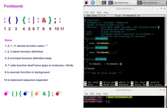

I found @berto's fork bomb program is a bit newbie scary. So I am learning Bash to find out what that fork bomb is doing. Basically it is just a function named ":", which is defined as a function calling itself two times, thus forking indefinitely, as fast as rabbits growing exponentially, using up all the resources, and crashing linux.
fork bomb
I have also found the following interesting version of forkbomb using Unicode symbols:

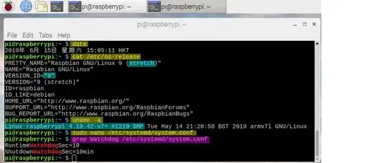

I found @berto's suggestion of using Rpi's hardware watchdog timer also very good. I have not played with any watchdoog stuff before. So I am going to try it now. @berto's instructions are very detailed, but still a bit hard for me, because I don't know very well the meaning of the commands "grep" and "dmseg". So I googled and made some reading notes in the appendices below. Then I followed @berto's suggestion, and strugged a bit to complete part 1. I have not yet reboot, because I need to take a break to digest things. Anyway, here is the screen capture.

I rebooted and got the following dmesg:
watchdog 3
I think I am going too fast and now need to take a break to first study more linux things, like systemd, before coming back to carry on the test on watchdog.

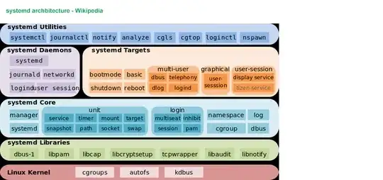

systemd architecture
/ to continue, ...

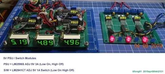

I have the same problem. I am building a rooftop garden with a couple of Rpi's each of which connects to various wireless stuff (BlueTooth, Wifi) sensors, relays, and solenoids. There are two huge motors near by, controlling big water tanks and lifts. The motors generate EMI and from time to time freeze nearby electronics things.
My plan is to use software switchable PSUs (Power Supply Units) to power switch off/on frozen Rpi's and other devices (Bluetooth devices freeze most often. The BlueTooth and other little devices do not have any software reset command or hardware reset pin, so powering off/on their 5V Vcc is a quick and dirty, but still safe get around). In short, The Rpi's regularly watch each other and their devices and POR (Power On Reset) any guy fallen to sleep.
Of course I can also use a GPIO pin to trigger the Rpi hardware on board reset pin. But I am too lazy to do extra wiring, and too poor a hobbyist to afford professional/industrial grade non stop system devices such as the SwitchDoc Labs Dual WatchDog Timer (see reference below)

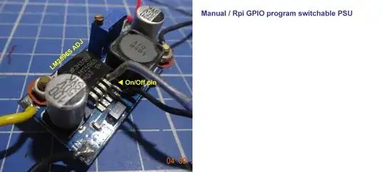

I modify ordinary DC-DC (12V to 5V) PSUs' so that any Rpi or MCP23x17 GPIO pins can power on/off the LM2956/LM2947 voltage regulator chip of the PSU. (LM2941 can be used for 1A current switches, LM2596 for 5V 3A PSU. The on/off pin is also connected to a push button, for manual power on/off testing.)
Actually each of my 7 Rpi3B+'s is connected to a cheapy DS3231 Real Time Clock Module which has a hardware interrupt pin to reset PSU, Rpi, or other devices.
Whenever possible and practical I tie up all the devices' reset pins together (removing some of the pull up resistors, so not to overload the GPIO pin).
Now the external DS3231 RTC wakes up everybody in the morning, and switches off lights at midnight, so everybody goes to bed.
