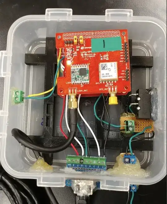

Our nodes are currently equipped with:
  • Raspberry pi zero W
  • Dragino LoRa Module
  • RFID sensor
  • Weight sensor
  • DC-DC converter
  • 15Ah lead acid battery
Original node prototype
