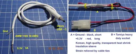

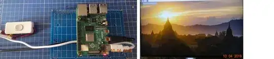

(2) DIY a manual cable power switch (Appendices A to C).

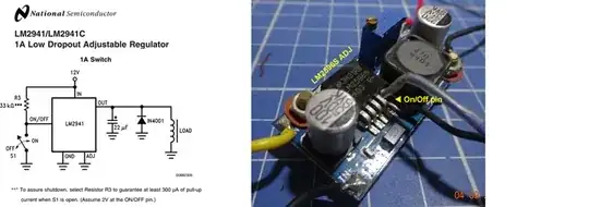

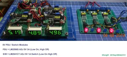

(3) Using Rpi GPIO to control a software switch to turn on/off the power supply for the cooling fan (Ref 6, Appendix C)

(2.3) Lengthen the power cord at either or both ends of the manual power switch (Appendix A, Tamiya socket labelled "B"). This way, the OP needs to carry the switch with a dangling long power cord to bed. But this method is easy. One problem is that Rpi won't be properly shutdown.

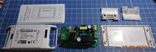

In Case 2.4 above, I suggest using a WiFi power switch such as Sonoff, but I am not sure if the OP is confident to to the wiring of 200VAC wires. I also googled IoT Stack Exchange and found 50+ posts suggesting using a WiFi power switch, including how to use Sonoff's GPIO pins to do other things (Perhaps turning on/off the OP's case's cooling fan, as well as the Rpi power.)
Again, this is a bit risky and not recommended to newbies. So in case if the OP is interested in the approach,
I would suggest the OP to move this question to IoT Stack Exchange, ...

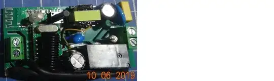

sonoff_2019oct0601
sonoff_2019oct0602
sonoff 2019oct0602

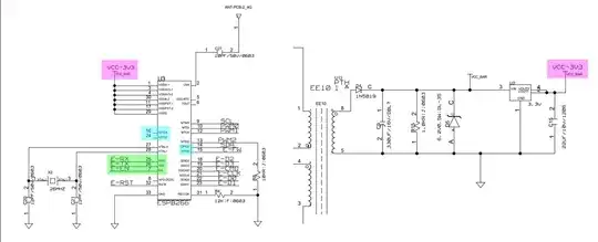

For those those are interested to learn about Sonoff, IoT MQTT, ESP8266 etc, and dare not to touch the dangerous 200VAC mains, you can consider doing the following experiments.
(1) Open the Sonoff cover (it is hacker friendly, takes your less than 3 seconds)
(2) Study the schematic, find where the AC200V to 3V3 transformer output, remove the AC circuit, supply your own 3V3 power. Update (Ref 22 Youtube has a very good description of how NOT removing AC to DC converter circuit and can just supply your own 3V power from Win10 USB to UART TTL.)
(3) Find the ESP8266 chip's TxD, RxD, GPIO pins and use Rpi ESP8266 IDE to program the ESP8266.
There is a tutorial (Ref 20) on how to use LUA to program the ESP8266/ Sonoff smart switch. This tutorial is simple because it does not make use of any cloud, third party server, MQTT broker, you just use your smart phone to WiFi talk to ESP8266 whose pins can do the following: (1) switch on/off Rpi (logic or power circuit), (2) switch on/off cooling fan, with the help of ddriver 2N2222.
WARNING: I myself have not tried it. So there is no guarantee that something won't explode!

(6) Using LM2596 and LM2941 to switch on/off PSU/currenct

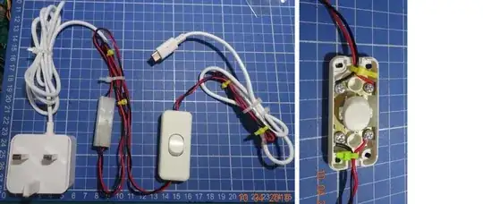

Appendix A - Power Switch DIY Notes 1 - Cutting power cord to insert switch
stripping wires
Appendix B - Power Switch DIY Notes 2 - Switch inserted
pss switch
Appendix C - Rpi4B + PSU - Power Switch Testing OK

Appendix D - Using A Software Switch to switch on/off cooling fan power
psu switch 1
psu switch 2
Appendix E - Sonoff Smart Remote Control Wifi Switch
Product Spec
Supports 2.4G WIFI router and 2/3/4G mobile network (5G router not supported)
Power Input - 90 ~250VAC
Maximum load current - 10A
Only use “eWeLink” free app.
Security Mechanism: WEP/WPA-PSK/WPA2-PSK
