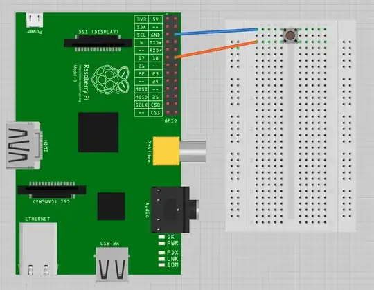

I've seen a tutorial here that shows me how to do this:
one-gpio-button

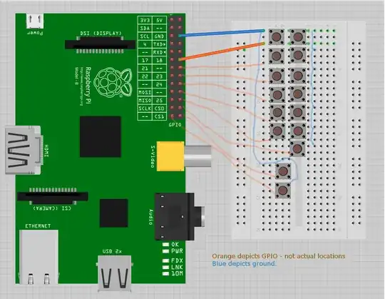

But what I want to do is like this:
I want to have multiple buttons and distinguish between them. The graphic I painted depicts the desired layout of the buttons and how I propose arranging them and connecting them.
So my question is, is what I'm planning to do possible? And how may I distinguish between first- and second-row buttons in Python?

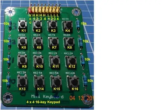

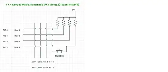

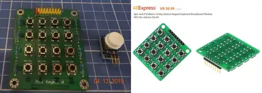

To distinguish 128 buttons in a row is a bit messy. So all these years the EE guys have been using the standard matrix wiring method to make their job easier. A simple example of 16 buttons or keys (actually "button" and "key" are the same thing), wired in 4 rows by 4 columns matrix (you can buy one from eBay for less than one US dollar!)
4x4 keypad
keypad schematic
Now of course you can use 8 Rpi/MPU GPIO pins to scan a 4 x 4 = 16 key keypad. But of course the clever EE guys would not waste 8 GPIO pins, so they use MCP23008 with 8 GPIO pins, so not bothering Rpi which would do other chores and only when interrupted by MCP23008, then diverted to check which key or keys are pressed. If you want 64 keys, then you can use MCP23107 with 16 GPIO pins to scan a 8 x 8 = 64 key keypad.
For "humble" newbies, I would recommend to start with only 4 Rpi GPIO pins, to scan a corner of the cheapy 4 by 4 keypad (yes, you don't need to scan all 16 pins, to make things newbie friendly)

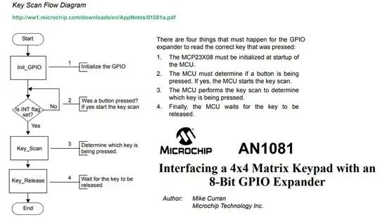

To give you a very rough idea of the scanning thing, the flowchart below should be helpful.
scan flowchart
The flowchart shows a general scanning method for both using Rpi GPIO pins or MCP23008 pins.

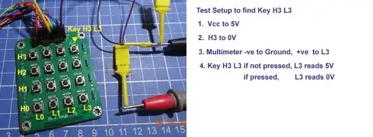

How to test one keypad key
How to check one key
How to test multiple keys pressed at the same time

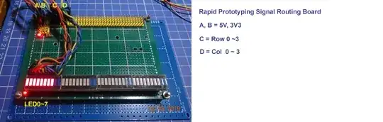

One good thing about use matrix keypad is that individual key interrupt pins can be "logically" connected so that when one or more keys are pressed, only a combined single interrupt goes to Rpi (which is not wasting time busy looping, but doing other useful non keypad related thing) which can first take note of the interrupt event, then later when free, leisurely check which keys are pressed. A handy hardware troubleshooting tools is also displayed below.
led array

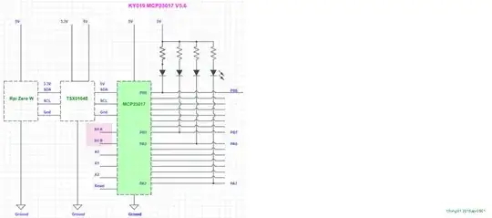

Warning to newbies - DON'T jump start with MCP23017!
For those brave, proud newbies who (almost always fail eventually! :)) want to jump start with a 64 key keypad using MCP23017, I would like give a severe warning - MCP23017 has a very steep learning curve, and is absolutely not for the faint of hearts. Just in case some curious newbie wants to have a look of the deceptively easy circuit, here is an oversimplified schematic.
Good luck to your multiple GPIO button project! :)
mcp23017 keypad

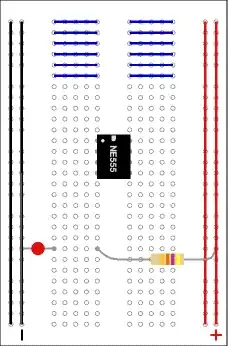

While it is possible to connect multiple buttons to the Pi's GPIO and read them in a python loop the second that second "schematic" will not work. Note that ABCDE and FGHIJ columns are connected for each numbered row. Placing the buttons as shown will make it impossible to distinguish between the two buttons on each line. In this particular case one would want to replicate the setup shown in the first image as posted in the question - placing all buttons on separate rows.
This is how breadboard holes are usually connected (blue lines), follow-up reading at electronicsclub.info. Note that the left and right columns (marked red and black) are all linked together and are usually used as power rails, i.e. connecting GND and VCC. Using them GND could be connected just once to the Pi's GPIO header and then distributed to the buttons at the breadboard.
source, image by John Hewes
