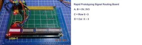

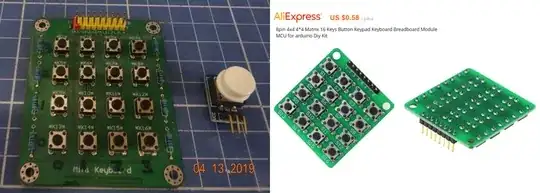

Step 1 - Start with a cheapy (US$1) 4 x 4 push button keypad, program 8 Rpi GPIO pins to scan keypad, using edge and level interrupts.
4 x 4 keypad

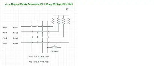

key matrix

Update 2019apr13hkt2130

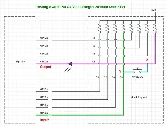

Now I am thinking of how to test just one key switch SW R4 C4. The algorithm is roughly summarized below.
test switch SW R4C4
1. Set GPIO pin connected to Row 4, PinR4 as output
2. Set GPIO pin connected to Col 4, PinC4 as input
3. Write PinR4 Low. The line connected to PinR4, including point X,
   will be pulled low
4. Polling (repeatedly reading) PinC4 will return High, until switch
   SW R4C4 is pressed, Y is shorted to X, therefore the line connected
   to PinC4 will now also be pulled Low, and PinC4 will read Low, indicating
   that SW R4C4 is pressed.
Now I am studying the keypad. This is what I played in pre Rpi days, some 6 years ago.
4 x 4 keypad

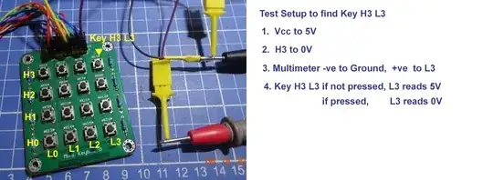

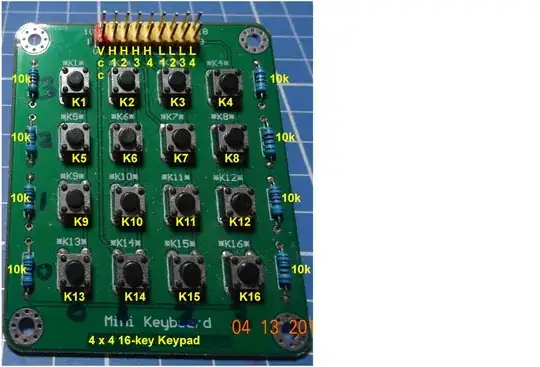

Now I have setup and found where is the key H3 L3 and other keys, as shown below.
find key h3 l3 (R3, C3) and other keys

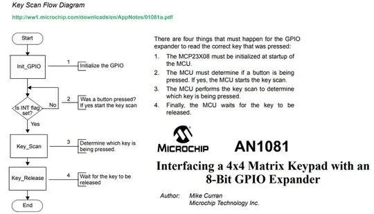

AN1081 Title: Interfacing a 4x4 Matrix Keypad with an 8-Bit GPIO Expander -04/12/2007 Mike Curran
Description:
This application note discusses interfacing a 4x4 matrix keypad
with MCP23X08 8-Bit GPIO Expander.
