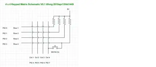

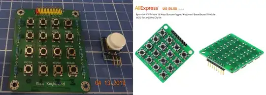

The EE guys usually wire the buttons, say 256, into a 16 x 16 button/key matrix. A couple of years ago I read a MagPi article introducing an GPIO expander called MCP23008. I found MCP23008 very interesting and read the datasheet and application note. The app note explains in details how to use MCP23008 to detect a 4 x 4 keypad, and the program to scan the keypad. I goggled one and also found many Arduino C++ programs using GPIO or MCP23017 for 8 x 8 key pads.
For newbies, I usually recommend not to start with MCP23008/MCP23017, because their learning curve is very steep.
I would suggest to:
start testing as simple as possible:
using only 2 Rpi GPIO pins to detect 4 buttons.
The principle of doing 2 x 2 = 4 keys is exactly the same for 16 x 16 = 256 keys. You might like to read my answers to the following posts to get a rough idea of what I am talking about.
