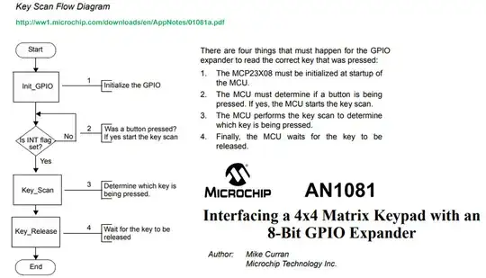

Well, you don't need to write pin interrupt functions yourself.
The python module will setup interrupt pins during start up and interchanging row and columns as interrupt/input and output rows and columns. Everything is done in the background.
You might like to read my answer for more details of the keypad scanning algorithm to the question in Ref 3.
Note the "Is interrupt flag set condition" in Step 2 of the keypad scanning flowchart.

Appendix A - MicroChip Keypad Scanning Algorithm - MicroChip
keypad scan method
