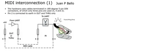

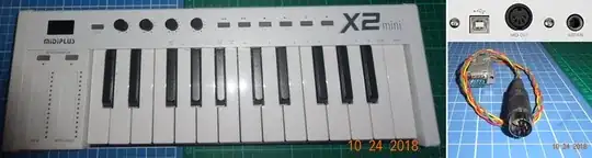

  4. Midi devices use a very old style 5 pin UART like connector for serial communication, so Rpi UART should be able to talk to a Midi device (but with some modification, because Midi UART is not pure UART). I have a MidiPlus X2 Mini and found it quite "portable". There are python Midi libraries available. I tried the beginners ones and found them OK. You may find the referenced video showing the USB and serial connector sockets at the back of the keyboard.

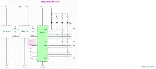

  3. Below is a basic schematic showing the wiring of interrupt pins.
    MCP23017 with interrupt

  4. MidiPlus X2 mini Keyboard Controller
    MidiPlus Mini X2 Keyboard Controller

    Data Communication/MIDI - Juan P Bello
    Rpi Midi UART interface
