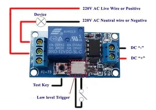

first off, I'm a noob when it comes to hardware/electronics. Barely started and not planning on getting too deep in it.
Now, what I am trying to do may not be possible, hence this question. I have this latching relay latching relay and it works as expected (not sure if it counts, but I have the 5V version of this, no the pictured 12V. Everything else seems the same though)
There are 2 pins in that white area that is the "low level trigger". I found that I can take just 1 of the pins from the "low level trigger" and if I tap it to the DC "-" connector, it will latch (basically, acts like the button). It's the one from the left; it will not work with the one from the right.
Now I'm trying to find a way to connect everything so that the relay is powered by it's own 5V power source, the RPI is powered by it's own power source, and I want to connect just 1 pin from the RPI to control the latching on the relay (so one of those 2 pins/wires on the relay).

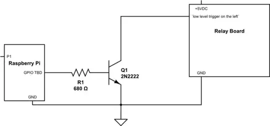

From the information in your question, it seems reasonable to assume that the "low level trigger on the left" may be used for your "one pin connection" to the RPi. However, there is one important caveat:
DO NOT connect the low level trigger on the left directly to the RPi. It likely has 5VDC on it. If it does, and you connect it directly to a GPIO pin, your RPi will become a paperweight. This is because the RPi GPIO pins are biased at 3.3VDC, and they are very fragile.
Instead, you will need an "interface" between the low level trigger on the left and the RPi. I'll show this generically in the schematic below. Basically, it will work like this:
Your software program on the RPi will drive the GPIO pin you've chosen to an "active high" state (i.e. its output is 3.3VDC). The GPIO pin will be connected to the "base" terminal of the transistor Q1. Once the GPIO pin goes "high", transistor Q1 will be "turned on", and conduct current between its collector and emitter terminals.
schematic
And so, "this" is a way to achieve your objective. I'll not go further as that may be a waste of time. Review this, and if you'd like to proceed, post a comment. We'll go from there.

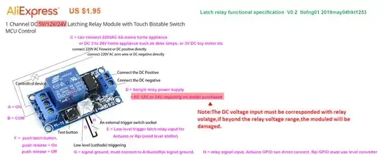

No problem. Let us first begin with the latch relay features/operation/functional user guide/specification as display below.
latch relay spec

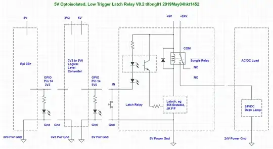

Now I have drawn a schematic showing 4 parts/modules. Each of the 4 parts are loosely coupled, and can be separately tested. The OP has already manually by hand tested one of the four parts - the latch relay.
The rightmost part can be easily tested using a 24VDC desk lamp.
The Rpi part can also be easily tested by a simple python blinky LED program.
The 3V3 to 5V0 logical level converter/up shifter can be a simple 2N2222 pull down/sink driver, or any other circuits with a similar converter function.
As the OP has more than one relay, I would recommend the HCT125 quad logical level converter, as described in the reference below. There are many more ways to do level shifting. The second link describes some of them.
74AHCT125 - Quad Logical Level-Shifter - Adafruit
Four ways to do logical level shifting - tlfong01
After all 4 parts/modules are separately tested, the OP can do incrementally integration and testing. For example, add logical level converter to Rpi, and test two together. Then add latch relay to the two, and tested three together.
There is no need to add the desk lamp when testing the left three modules, because relays switches with a click sound, implying Songle switch contacts are breaking or making. Finally the desk lamp can be added, and all 4 modules tested together, and day is done!

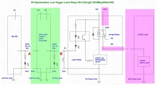

latch relay test
Get around of replacing logical level converter by just a 4k7 resistor
Actually there is quick and dirty get around of not using any logical level converter. This get around or trick is to insert a 4k7 resistor between Rpi GPIO pin and latch relay input pin, between points A and B as shown in the picture below.
For testing only the pink part (desk lamp) can be removed.
However, Rpi 3V3 ground and Latch relay 5V power ground still needed to be connected, to make a common signal reference point.
Warning - There is a risk of this get around. There is 1% chance that you Rpi will be killed immediately, 2% chance killed in 30 minutes, 3% chance Rpi's life shortened. The killer cause is called "latch up" effect, which happens when Rpi GPIO is connected through a resistor to 5V. The latch up effect is a subtle concept which I am not able to explain in less than 15 minutes, using less than 500 words, without a couple of illustrations. You might like to read more details in the references below.
get around
