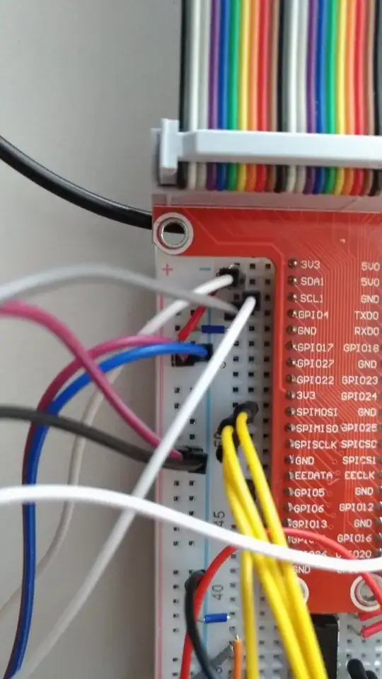

I'm doing a project for a school assignment and have some issue with my circuit. When I connected the breadboard to pi and to power, everything was working, I could read data from sensors and looked fine. However, after 30-50minutes my pi stopped working and a green LED is dead. I believe I have burnt my new pi. I just want to know what happened, what I'm doing wrong before I'll try to run this on a new pi. First of all, I would like to ask if there's a limit to wired sensors/devices because I'm using a few. Maybe it was an issue?
Let me describe my circuit:
  • Serial LCD wired to SDA, SCL
  • DHT11 temp&hum wired to GPIO4
  • MCP3008 wired to MOSI, MISO, SCLK, GPIO5. I'm using only 1,3,5,7 channels. unused are wired to GND to reduce the noise. Used channels go down on the breadboard and are connected to soil moisture sensors (please see attached picture).
  • 4 soil moisture sensors connected to analog inputs in MCP
  • 4 diodes (red, green, blue, white), 4 resistors 220 R, each diode connected to GPIO to manage them from phone app I'm wiring 3V3 output to + in the breadboard and every sensor/device is wired to this power. I'm wiring 2x GND outputs to - (left and right side of the breadboard).
Please see attached pictures: circuit with mcp, dht11, lcd, leds enter image description here

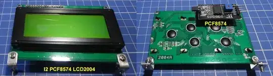

For example, I play with I2C LCD shown below.
I know these LCD are almost always Arduino compatible (I played with them in my Arduino days) - In other words Vcc = 5V. That means it is NOT Rpi compatible. The chip PCF8574 is very likely Vcc = 5V. I am pretty sure, because I never apply Vcc = 3V3 for the LCD and all the other I2C SPI guys.
I am not suggesting you to use logical level converter, like me. But if you direct connect Rpi 3V3 GPIO to 5V devices, it might work for some time, but sooner or later it will burn.

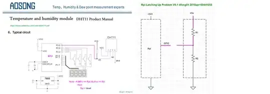

To summarize, if you connect Rpi GPIO even through a resistor to 5V, then Rpi might have its life shortened, if not burnt immediately. The picture show why DHT11 with Vcc = 5V might be a problem. See my answer in the above post for more details.

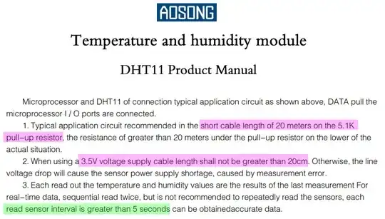

  1. You can use Vcc = 3V3 if your cables are only 20cm short.
  2. You can use cables 20 meters long if Vcc = 5V.
  3. DHT11 is slow and needs a couple of seconds to complete a job. So if you ask too frequently, it will go crazy and give you nonsense answers.

They may protect against low current transient events caused by transient out-of-range voltages applied to the pins, but they are not intended to protect against the application of voltages greater than the supply voltage or less than ground, even with an external series resistor
In brief, you should never deliberately forward bias those "diodes". Consequently, you can not safely place an external pull-up resistor to 5V on the I/O pin. That would forward bias a parasitic FET and owing to its poor internal impedance to the chip's internal power rail it may overheat, or worse, it may bias up parts of the chip to voltages greater than they can handle.
So, don't do it!
