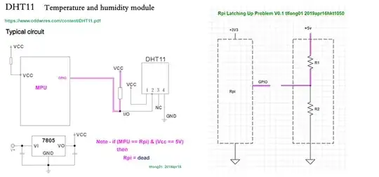

Well, if you are connecting a GPIO pin to any pin of a 5V powered device, then there is risk of frying the Rpi or shortening it life。 You might like to read the following posts for more details.
DHT11 sensor and the wrong voltage may have fried my RPi3 [Rpi Latching Up Instant Suicide]
latch up problem
Circuit wiring issue [Rpi Latching up Slow Suicide]

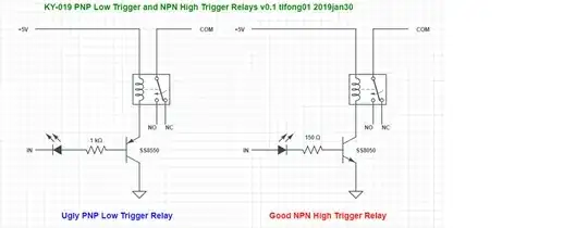

Rpi 5V Low Trigger Relay Latching Up Risk Notes
relay latch up

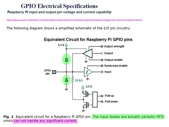

Appendix A - Warning on dangerous pulling up GPIO pin to 5V
GPIO Electrical Specifications Raspberry Pi input and output pin voltage and current capability - Mosiac Documentation Web
latch up problem
GPIO pin circuitry
The internal diodes shown in the figure are not really substrate diodes, but they are actually parasitic FETs.
Electrically, their I-V characteristic looks like a diode's, but with a greater forward drop and a more gradual knee.
They may protect against low current transient events caused by transient out-of-range voltages applied to the pins, but they are not intended to protect against the application of voltages greater than the supply voltage or less than ground, even with an external series resistor.
In brief, you should never deliberately forward bias those "diodes".
Consequently, you can not safely place an external pull-up resistor to 5V on the I/O pin. That would forward bias a parasitic FET and owing to its poor internal impedance to the chip's internal power rail it may overheat, or worse, it may bias up parts of the chip to voltages greater than they can handle.
So, don't do it!
