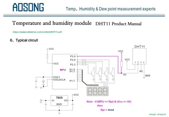

TL;DR: Do not power the DHT11 with 5V and drive rPI GPIO with 5V: you risk damaging your rPi
The OP did not include the pull-up resistor, which I assume is to ensure that GPIO is driven with 3.3V (NOT 5V):
I found this post on this forum, and also this link from another site which stated that the 5V pin should be used. I connected the 5V to the sensor while I hadn't put any resistors in the circuit at all. The Pi crashed immediately, but then came back online with a recovery screen, and worked without issues for a while.
Joan advised that a pull-up resistor was required in a 5V configuration:
It should be possible to do as follows: Connect Pi 5V to sensor +, Pi ground to sensor ground, and any GPIO to sensor data. You ALSO need to connect a 4k7 (or thereabouts) resistor between the data line and 3V3. In other words leave the data line pull-up connected to 3V3 but power from 5V. I have not tested this but I'm told it will work by those who know more than me.
It is not clear to me that Joan's statement will work nor is it clear if it will damage your raspberry pi. I do not advocate Joan's untested solution, however, if you are brave enough and willing to test this configuration, then by all means post your results whether you are successful or it damages your raspberry pi

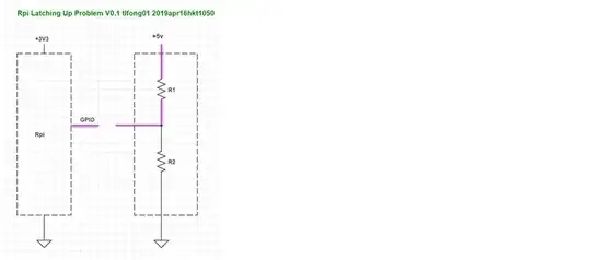

It is a long story that I am going to tell later. First, an illustration.
latching up
The Dangerous Configuration Causing Latching Up
Newbies usually unintentionally connect a resistor between GPIO and 5V, in many situations include the following.
For an Arduino low trigger 5V relay. Rpi GPIO Low signal can switch on relay, but cannot switch it off, because the relay is designed to switch off when High signal is above 4V, the Arduino standard High. However, Rpi High is only around 3V, therefore not High enough to switch off the relay. In other words, the relay is always on.
The clever newbies have invented many ways to get around the Rpi High not high enough problem.
  1. Set GPIO to input mode. This way is almost electrically equivalent to a 5V High signal as seen by the relay, which happily then switches off.
  2. Pull GPIO up by a 10k resistor, wrongly and dangerously hoping that GPIO can therefore go higher enough to switch off the relay.
Both methods might cause latch up. The configuration is illustrated below.
rpi latching up

Now, some references on latching up:
GPIO Electrical Specifications Raspberry Pi input and output pin voltage and current capability - Mosiac Documentation Web
GPIO pin circuitry
The internal diodes shown in the figure are not really substrate diodes, but they are actually parasitic FETs.
Electrically, their I-V characteristic looks like a diode's, but with a greater forward drop and a more gradual knee.
They may protect against low current transient events caused by transient out-of-range voltages applied to the pins, but they are not intended to protect against the application of voltages greater than the supply voltage or less than ground, even with an external series resistor.
In brief, you should never deliberately forward bias those "diodes". Consequently, you can not safely place an external pull-up resistor to 5V on the I/O [GPIO] pin. That would forward bias a parasitic FET and owing to its poor internal impedance to the chip's internal power rail it may overheat, or worse, it may bias up parts of the chip to voltages greater than they can handle.
So, don't do it!
Latch-up - Wikipedia
Parasitic structure - Wikipedia
/ to continue, ...
DHT11 Datasheet - Aslong
