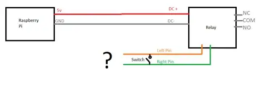

Like the original author, I noticed the left pin, when attached to the ground, will trigger the relay. However I want to be able to control it from both the raspberry pi, and a momentary switch (which I want to work even while the pi is off) .
Currently I'm here:

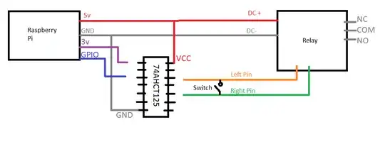

For now, could you explain like I'm Five what I need to do to accomplish this? If I had to take an educated guess, this is what I would end up with:
I have no limit on how many connections I can make, like the op in the post above seemed to, as they'll be in close proximity of each other. I just need the gpio to be able to trigger the latching relay by any means necessary essentially (and hopefully not kill the pi).
If you could sketch up what you would have me do, that would be greatly appreciated. I'm aware tlfong01 did just that in the post, but it has me lost. it looks like in his drawing, GND is going to 3Y according to pinouts on this? (Rhetorical) https://cdn-shop.adafruit.com/product-files/1787/1787AHC125.pdf I'm not even sure if that's right, or what 3Y is, and could very much use a... 5 year old friendly drawing if that's not asking too much.

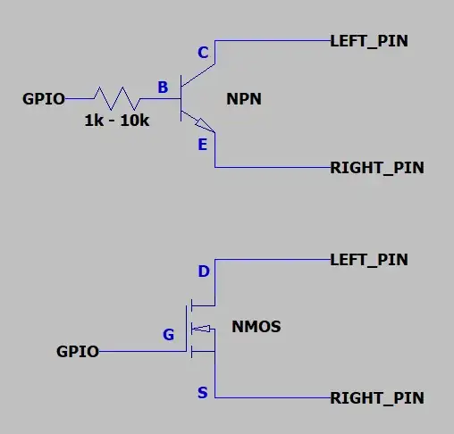

Here are two simple ways to do it: enter image description here
Pick the circuit that works with parts you have available.
For the NMOS (N-channel MOSFET) circuit, any described as logic-level will work.
For the NPN circuit, any will work. Common ones are 2N2222A & 2N3904 & BC547. The resistor value isn't critical, it just protects the transistor and IO pin from excess current.
When the GPIO signal is driven high, the transistor turns 'ON'. This draw the left and right pins towards a common potential (i.e. same voltage). Since the right pin is connected to V-/GND, you are essential connecting the left pin to ground like you did with your testing.
One general note; when connecting two boards you usually need a common ground connection. The circuits you've posted are powering the relay board from the Pi and have that common ground between GND and V-. If you were powering the relay board from a different source (like 12V power supply & relay board) you could not get away with single GPIO wire. You would also need to add a connection between GND and V- (or right pin since it connects to V-).

You now say a contact closure to "connect the left pin (view picture, Orange) to ground" will work.
Unfortunately microprocessors DO NOT do contact closures. You would need a relay, but using a relay to control a relay seems overkill.
There are very many people on this site who attempt to help, even when there is insufficient data to formulate an answer. Some then post speculative answers, and I am about to do the same.
If I was doing this I would first verify that the Orange pin has a +ve voltage on it. If so the following should work. You would need to write some code to momentarily turn the transistor on.
NOTE I definitely wouldn't use a tri-state buffer as suggested in your question.
schematic
