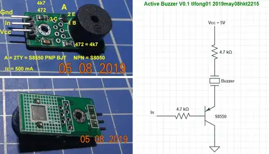

Update 2019may08hkt2153

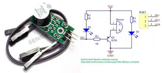

I am testing out the following active buzzer to confirm my suggested get around of using 4k7 works.
The OP uses the following active buzzer with the ad saying is it both Rpi and Arduino compatible.
Active buzzer buzzer sound alarm module cable Raspberry Pi Arduino active
Active buzzer 1
I found the schematic for Sunfounder's buzzer but it doesn't look like the OP's buzzer. So I need to use a multimeter to trace the components to draw a schematic, as shown below.
active buzzer
/ to continue, ...
