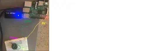

I'm trying to light up an LED and play a buzzer noise at the same time. Here is my code so far:
Import RPi.GPIO as GPIO
Import time
GPIO.setmode(GPIO.BCM)
GPIO.setup(7, GPIO.OUT)
while True:
    GPIO.output(7, 1)
    time.sleep(2)
    GPIO.output(7,0)
    time.sleep(2)
GPIO.cleanup()
and here is how my RBp is connected:
https://i.sstatic.net/QA4uZ.jpg
The LED lights up as expected but all I'm getting from the piezo is a very short static noise as if it's getting electricity. But no sustaining noise.
I don't think theres anything wrong with the code as I've seen multiple examples online that are basically identical and work with no issues. The buzzer I'm using is from the arduino starter kit if thats any help.
If anyone can help me figure out why it's not working that would be very appreciated!

(1) You seem to have connected Rpi's 40 pin header's 5V power to one end of the piezo, and one GPIO pin to other end of the piezo. It is worse than connecting a resistor in a similar way. Rpi GPIO cannot stand 5V, and might fry even you connect through a current limiting protect resistor, say 4k7.

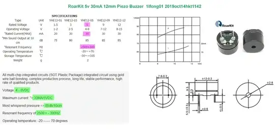

(2) If you have connected a piezo, it is even worse. Piezo might oscillate, with a starting spike, though very short, say 10uS, might be as high as 30V, and might also fry your pi.
(3) And even if your pi has not yet fried, the piezo can pass a current as high as 30mA, which is beyond GPIO limit. So it might also fry your Rpi.

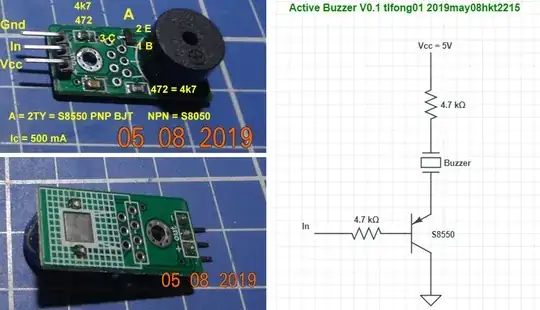

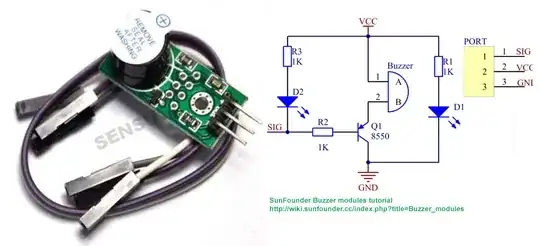

So you have already done 3 things to fry your Rpi. If your Rpi is not yet fried, I would suggest a better way, that is called active piezo buzzer (Appendix C below)

Appendix A - Piezo Buzzer Spec
piezo spec
Appendix B - Active Piezo Buzzer Circuit and Schematic 2
piezo 1
Appendix C - Active Piezo Buzzer Circuit and Schematic 2
piezo 2
