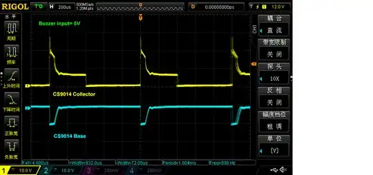

The Vcc = 5V NPN BJT driven buzzer's switching off back EMF can be as high as +20V at collector and -10V at base, which of course is risky at least to that part of the GPIO circuit, latching it up, killing it instantly, or in a short time of some 30 minutes, or shorten its life.

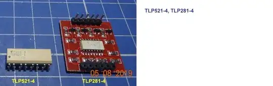

See the scope waveform below. Or use optocoupler/logical level shifter such as TLP521-4 or TLP281-4 module, to isolate back EMFs from inductive loads such as buzzer, relay, solenoids. Using optocouplers is almost a standard practive in industrial environments. My place is near a huge motor driving a heavy elevator for a 28 story building. So I also need optocouplers to isolate machinery noises.

NPN BJT driven Buzzer Back EMF waveform
Buzzer back EMF
Buzzer Back EMF Experiments

TLP521-4/TLP281-4 Octocoupler/Logical Level Shifter
tlp5214_2814_optocoupler

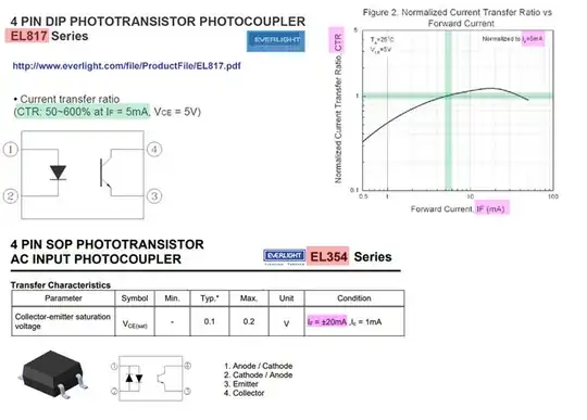

TLP521-4 and TLP281-4 are old, new replacements are EL817C and EL354
Alternative Optocouplers to replace TLP521/281/4

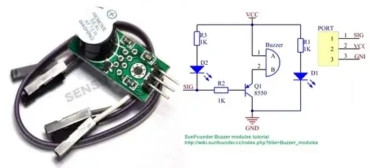

active buzzer always buzzing problem
Active Buzzer makes sound on both LOW and HIGH
Why active buzzer is always on.
The root cause is using an Arduino compatible active buzzer for Rpi. For this Arduino compatible buzzer, it is designed to be low active, ie, when input signal lower than about 1.0V buzzer will be on. And if input signal is higher than about 3.5V, buzzer will be off. Now Arduino has no problem, because its High is about 4.2V, well above 3.5V.
Now Rpi is in big trouble, because its High is only about 3V, no hope reaching the required 3.5V to switch off.
Get around
Easy - insert a 4k7 resistor between Rpi GPIO pin and input of active buzzer.
Quick and dirty explanation
The buzzer circuit input front end is very likely a PNP BJT. It is biased such that when input signal to base, through a biasing resistor, is 3.5V or higher , the transistor is cut off (Arduino High is 4.2V, therefore a clean cut off), no base current flows, therefore not enough collector current to activate the piezo buzzer.
Now Rpi's High is only 3V, therefore not high enough to have a clean cut off, resulting some base current, and therefore some collector current to partially/weakly activate the piezo, therefore the smaller buzzing sound.
The get around of inserting a 4k7 between Rpi GPIO and input is not to allow even small base current to flow, to get clean cut off, so no sound.
Now for the activating/on case, both Arduino and Rpi have Low level lower than 1V, therefore both have no problems switching on.
Actually Rpi has the same problem with a couple of other Arduino only devices, including 5V low level trigger relay. Similarly Rpi can only switch on, but not switch off. The same trick of adding a 4k7 resistor is the quick cure. Another get around it is the following:
