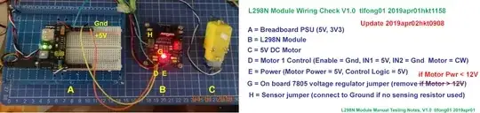

I would suggest to do the testing in 2 steps:
(1) Check by hand if jumper wire 5V, Gnd signals can move motor forward and backward.
(2) If motor can turn manually, then start writing the python program.
I googled and found almost all the L298N modules have the similar input and output terminal connectors. The following is my quick and dirty hardware wiring check. If you find this test OK, I can show you a very simple python program.
Wiring Notes:
(1) Remove jumper connecting on board 5V 7805 voltage regulator, If you are using external 5V power for both motor and control logic.
(2) Don't forget to short sensor jumper to ground, otherwise motor won't turn.

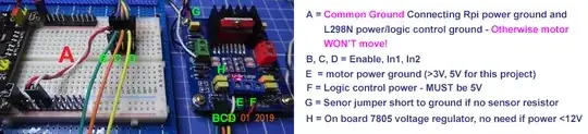

Final wiring diagram
Newbie reminder - connect Rpi Power Ground to L298N module power ground, otherwise motor won't move!

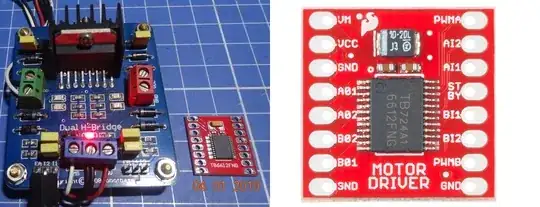

Recommending A Motor Driver Better Than L298N
After answering the OP's question, I began to worry that other newbies might think I like this L298N driver and encourage others to use it. Actually don't like this old chip at all, because new generation chips such as TB6612FNG are much smaller, more efficient, and not that harder to use. The picture below shows how smaller is the TB6612FNG module.
The Review of DC Motor Drivers - L298N, TB6612FNG and LV8406T
