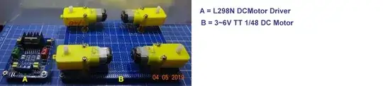

tlfong01's L298N motor driver and TT 3~6V motors
tlfong01's L298N testing notes
Update 2019apr05hkt2214
Motor Driver and Motor Compatibility Check
I checked the TT Motor at 4V5, and no load and stalled current to make sure the driver L298N DC current limit of 2A is not exceeded. The geared output shaft stalled (but non gear shaft still moving with slipped gear chain) shoots to over 250mA, but immediately returned to a stable value of about 130mA.
So far so good.

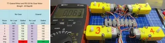

TT Motor Stall Current at 4.5V Vcc
I checked the stall current of the 130 motor without gearing, and found the stall current around 700mA. So a newbie like me should play with geared motor first, because the "stalled" current (when gear out stalled, but shaft still moving, with the gear chain slipping) is only around 140mA.

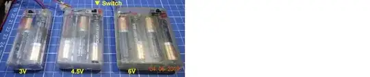

eBay AAA x3 = 4.5V Batteries Case with Switch Lead
The eBay Battery holder says "holder switch wire lead", but I don't see any switch on the holder. I usually use battery holders with a switch.
The manual switch is very useful when during testing you smell plastic burning, smoke coming out, motor finger burning hot etc, you can immediately switch off the battery. For the cheapy motors I am testing, I found them from time to time gets stalled because gears locked, and you need to start by turning it by hand. The stall current is many times than the steady current, so it is important to switch off the battery first.
battery case with switch

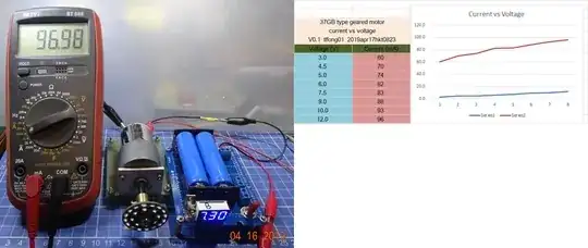

The Meccano motor looks like a big guy. Its shaft looks like 5mm diameter. Let me find a similar motor and measure the current.
Meccano motor
I searched my junk box and found a big motor looking similar to the Meccanno motor. I has a 5mm diameter shaft. I measured its current with different voltages and summarized the results in the following picture.
meccanno motor spec
