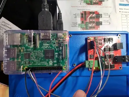

I bought two DROK L298 H-Bridges to control my DC motor (one for backup). I've connected it up to my Raspberry Pi 3 with BCM 12 as my PWM and 16 and 19 as my IN1 and IN2. Below is my code to test if the motor works - but it doesn't turn.
I tested the code on an L293D chip which turns the motor and tested both L298 H-bridges with no success. Looking for thoughts on how to get the motor working on the L298 H-bridge.

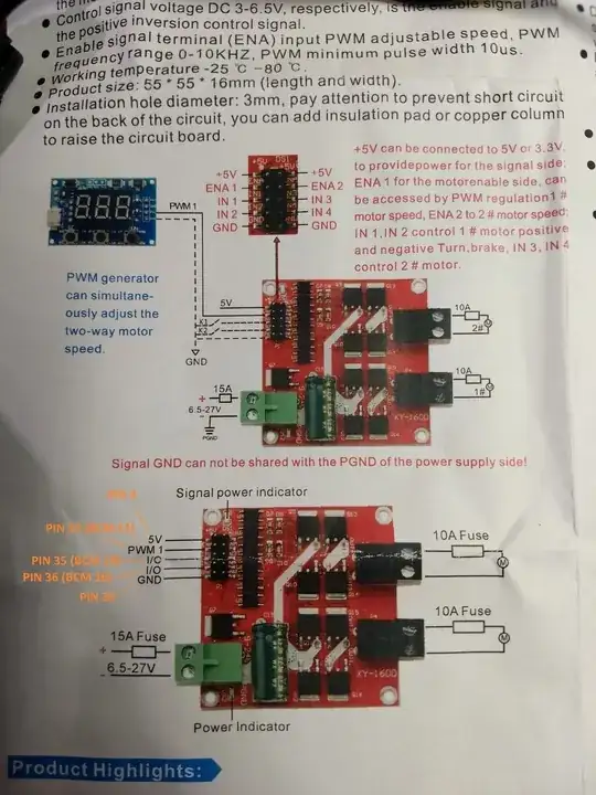

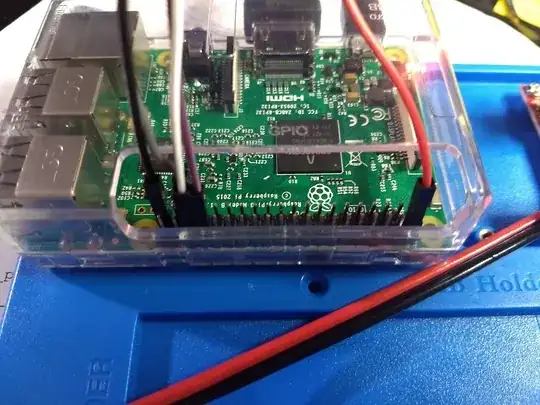

  • Update * Pictures of the spec sheet & connections
Connections
Connections2
Spec Sheet
  • Update 2 - Realized GPIO 12 was in the wrong pin. Changed it to the correct one (5th up) but still no motor turning.

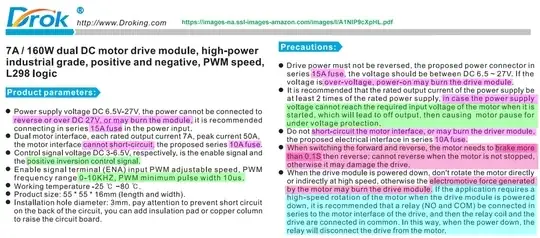

I read the Drok user guide and found that you need to be very careful when using this driver. You might like to check out the following precautions paragraph.
Drok L298N PWM 7A/160W DC Motor Driver
Drok L298N driver precautions

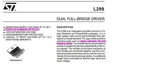

The big problem is that Drok say their driver is 7A, but L298N current limit is only 4A. Am I missing anything?
L298N current limit is 4A only
