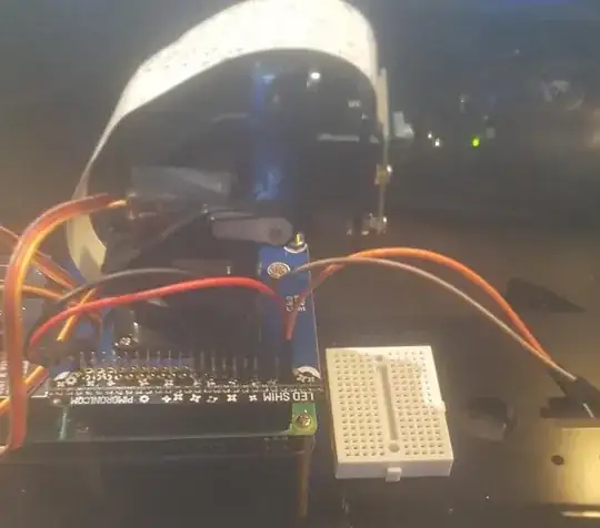

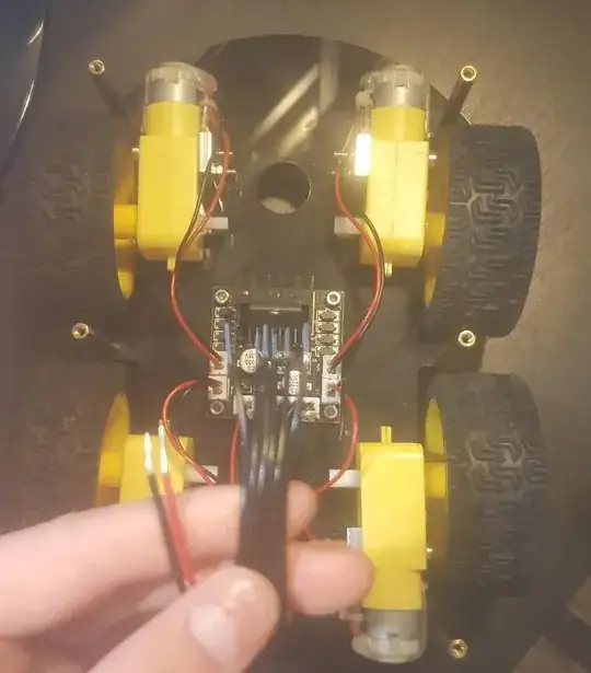

EDIT: Added some pictures Picture of my L298N driver wiring Picture of my RPi connections
The orange and brown wires are the motor driver's power and ground. EDIT 2: More pictures

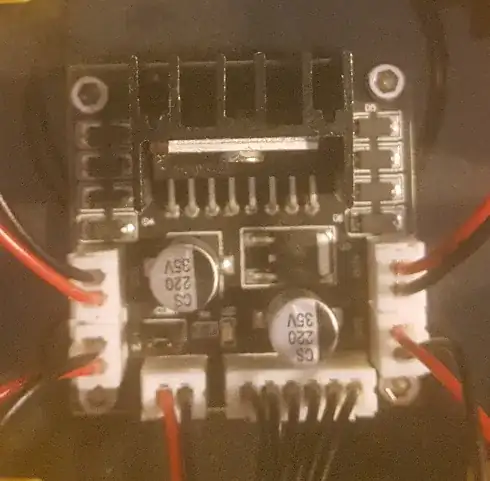

Picture of motor driver
There are no terminals. Just plugs.

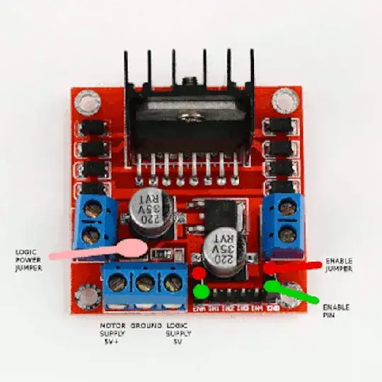

The L298N module typically has a terminal marked +5V (shown as logic supply 5V on the attached diagram).
As long as you do not connect this terminal to the Pi you will be fine.
I am not going to speculate further without a clear photo of the module you are using.
L298N motor driver module
The L298N module derives its logic supply power from the attached battery/power supply or the connected Raspberry Pi.
If the attached battery/power supply is 5V or more connect the logic power jumper (pink) and do not connect between the Raspberry Pi and logic supply 5V.
If the attached battery/power supply is less than 5V do not connect the logic power jumper (pink) and do make a connection between the Raspberry Pi and logic supply 5V.

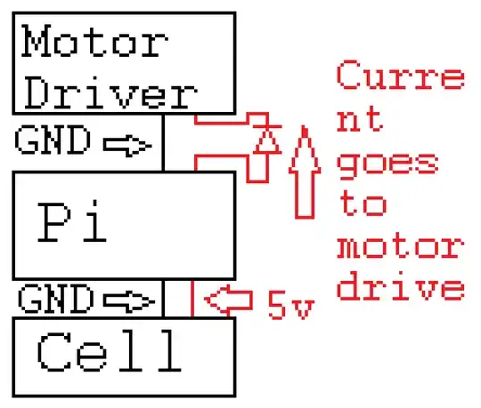

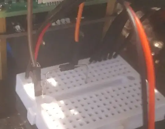

Adding a diode seems to prevent back power, while still giving power to the motor driver.Picture of Pi 5v to diode to the motor driver on breadboard
EDIT: Here is the schematic: enter image description here

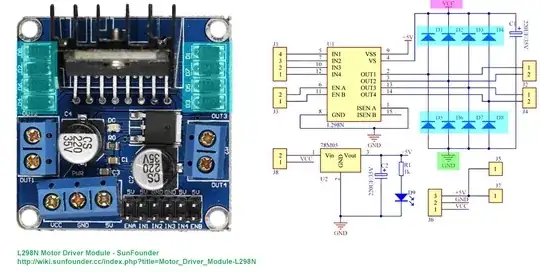

The OP is worrying that if he turns the L298N driven motor by hand, will the "back power" generated fry his Pi?
The L298N already 8 flash back diodes (D1 to D8 in the picture below) to protect the power to the L298N motor driver, so there is no need to add the extra one.
L298N fly back diode

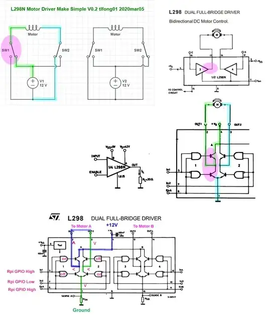

(1) We need to know what is going on inside the L298N circuit, before starting worrying. Now let us check out the basic operation, rerfering to the schematic of the post below.
Rpi python using L298 motor driver and PCA9685 servo controller to change speed and direction of robot car
l298n operation
(2) As we can see from the schematic, focusing on the left motor only, the three Rpi GPIO signals are used to switch on/off the four NPN BJT switching transistors, so to control the direction and frequency/duty cycle of flow the current through the motor, controlling direction and speed of the motor.
(3) One important point to notice is that the Rpi GPIO signals/connections to the bases of the transistors are only to control the switch. In other words, there is no motor current passing back to the Rpi GPIO, because the collector/base junction is reverse biased.
(4) Fly back diodes are used for uni direction inductive loads, or motors moving in only one direction (Ref 3). You MUST NOT use any such diode for bidirectional motors.
(5) Flyback diodes are usually biased to short circuit the back EMF current path, or wrong/reverse polarity battery current path. For wrong/reverse polarity power input, a backward biased series diode is used.
flyback diode
/ to continue, ...
