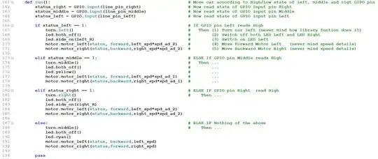

I am unable to understand the code provided with the raspberry pi robo kit I got. I need help in understanding the code as I am new to raspberry. Thanks!
#!/usr/bin/python3
    # File name   : findline.py
    # Description : line tracking
    # Website     : www.adeept.com
    # E-mail      : support@adeept.com
    # Author      : William
    # Date        : 2018/10/12
    import RPi.GPIO as GPIO
    import time
    import motor
    import turn
    import led
    def num_import_int(initial):        #Call this function to import data from '.txt' file
        with open("set.txt") as f:
            for line in f.readlines():
                if(line.find(initial) == 0):
                    r=line
        begin=len(list(initial))
        snum=r[begin:]
        n=int(snum)
        return n
    status     = 1          #Motor rotation
    forward    = 1          #Motor forward
    backward   = 0          #Motor backward
    left_spd   = num_import_int('E_M1:')         #Speed of the car
    right_spd  = num_import_int('E_M2:')         #Speed of the car
    left       = num_import_int('E_T1:')         #Motor Left
    right      = num_import_int('E_T2:')         #Motor Right
    line_pin_right = 35
    line_pin_middle = 36
    line_pin_left = 38
    left_R = 15
    left_G = 16
    left_B = 18
    right_R = 19
    right_G = 21
    right_B = 22
    on  = GPIO.LOW
    off = GPIO.HIGH
    spd_ad_1 = 1
    spd_ad_2 = 1
    def setup():
        GPIO.setwarnings(False)
        GPIO.setmode(GPIO.BOARD)
        GPIO.setup(line_pin_right,GPIO.IN)
        GPIO.setup(line_pin_middle,GPIO.IN)
        GPIO.setup(line_pin_left,GPIO.IN)
        motor.setup()
    def run():
        status_right = GPIO.input(line_pin_right)
        status_middle = GPIO.input(line_pin_middle)
        status_left = GPIO.input(line_pin_left)
        if status_left == 1:
            turn.left()
            led.both_off()
            led.side_on(left_R)
            motor.motor_left(status, forward,left_spd*spd_ad_2)
            motor.motor_right(status,backward,right_spd*spd_ad_2)
        elif status_middle == 1:
            turn.middle()
            led.both_off()
            led.yellow()
            motor.motor_left(status, forward,left_spd*spd_ad_1)
            motor.motor_right(status,backward,right_spd*spd_ad_1)
        elif status_right == 1:
            turn.right()
            led.both_off()
            led.side_on(right_R)
        else:
            turn.middle()
            led.both_off()
            led.cyan()
            motor.motor_left(status, backward,left_spd)
            motor.motor_right(status,forward,right_spd)
        pass
    try:
        pass
    except KeyboardInterrupt:
        motor.motorStop()

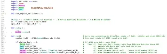

As soon as I run the module, the wheels turn left and the left led turns RED. I am unable to understand the significance of the variables and the run function code. Please help. Thanks.

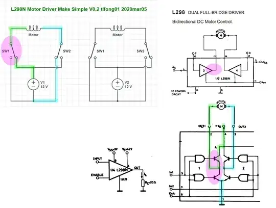

4.0 Schematic (L298 Motor Driver)
/ to continue, ...

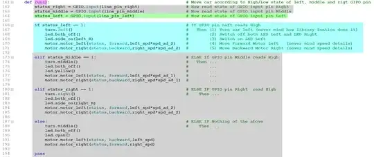

1.0 Answer

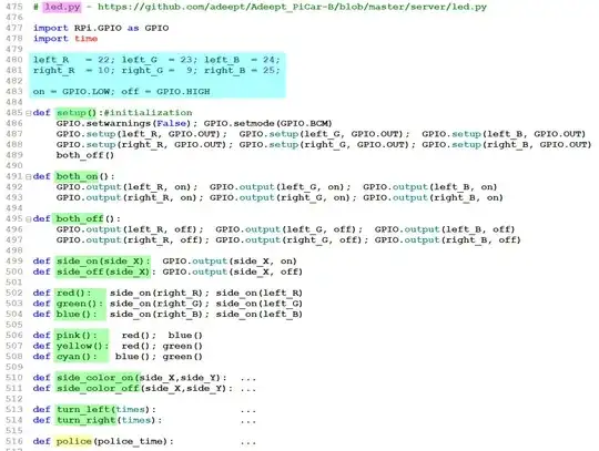

1.1 - Walking through low level (GPIO, DC motor) functions
Now I am zooming in the wood and forget the trees:
mov function reading
Now I am chain sawing away the branches:
mov function 2
Now I am tidying up things.
moving function 3
*Now I am zooming out to the three big trees, namely the python modules "motor"*, "turn", and "LED".
moving function 4
Now I am zooming out even further, to LED
moving function 5

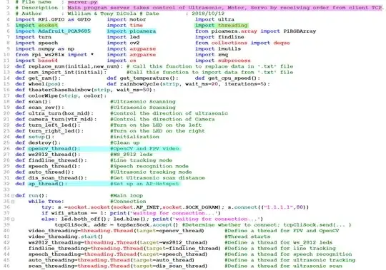

1.2 - server, run python modules summary
server.py
(1) Adeept Mars PiCar-B WiFi Smart Robot Car (Speech Recognition, OpenCV Target Tracking, Video Transmission) - Adeept US$95

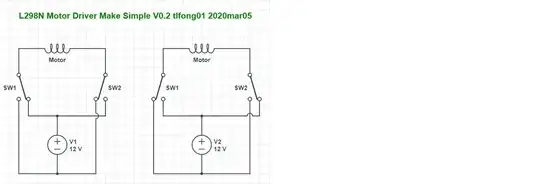

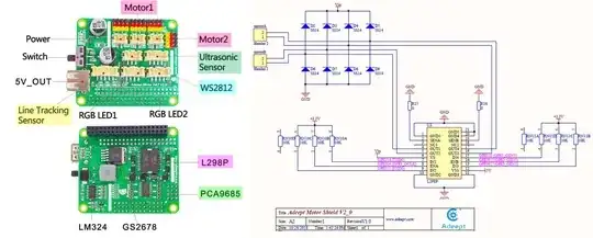

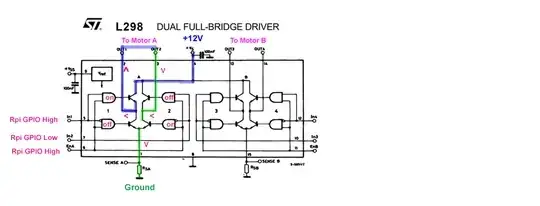

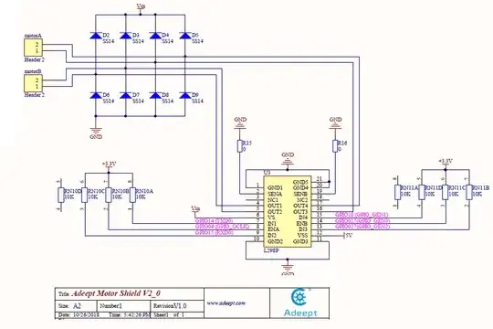

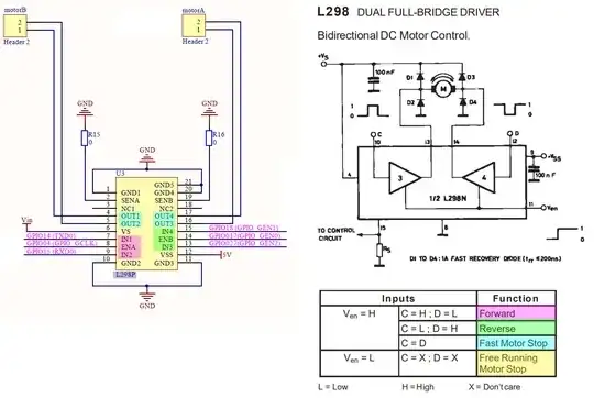

4. Schematic (L298 Motor Driver HAT)
L298 Motor Driver Schematic
motor driver connect
motor driver 3
motor driver 4
motor driver 5
l298n operation
