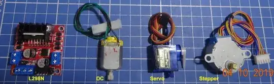

L298N driving DC, stepping, and servo motors.

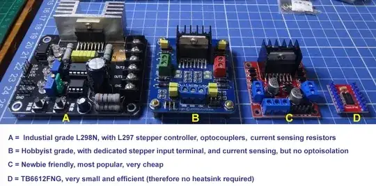

Now there are many types of L298N and TB6612FNG motor drivers, including the following.
l298n and tb6612fng motor ddrivers

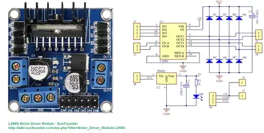

Now I am going to test the cheapest L298N module I can find. First thing first is to read the schematic, which newbies hate most, until they have burnt their motors and fingers. The more motors they burn, the more they would love to read the friendly schematic.
L298N schematic
The schematic is from SunFounder, whose L298N motor is much more expensive, and more newbie friendly. Their jumper row at the bottom is designed to make the no rpi, no software, dry run easy. To test, you just connect the left most 3 jumpers, ie, Enable to 5V, IN1 to 5V, IN2 to Ground, then the motor connected to the left output terminal would run. As simple as that!

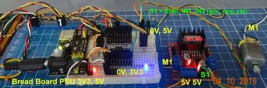

For poor hobbyist like me, I have to assemble three jumper wires, green, orange, yellow, for ENBL, IN1, and IN2. I connect IN1 to Ground, IN2 to 5V, and as soon as I connect ENBL to 5V, my motor will run (but not the newbie's motor, because they always forget to connect this and that wire, and when they are instructed to cut the blue wire, they would instead cut the red, wire, and of course the bad guy's time bomb explode).
So it is important for the newbie to first watch what the jinja hobbyist, ie, me, is doing, as shown below.
l298n wiring, dry run
