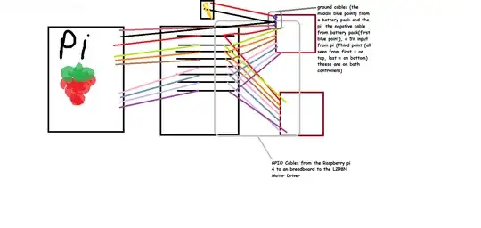

I'm using a pi 4 for a rover I want to build and I have 2 L298N drivers. I connected them using a breadboard to my pi so I don't need that much GPIO pins but only one pair of motors is working and when I unplug the driver that works the second pair of motors on the second driver are working. can u pls help me, I already double triple quadruple whatever checked my cables and connections but I can't find the error isn't there enough power output?How my setup works here u can see how I wired up all my cables.

The following two configurations work only one at a time:
(1) L298N Driver 1 (D1) works with motor pair (M1a + M1b).
(2) Similarly, D2 works with M2a + M2b.
There are a couple of possibilities, including:

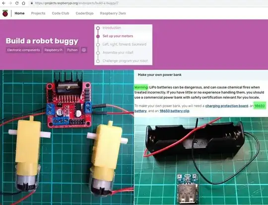

(a) Motor power too weak. The 5V power from Rpi4B's 40 pin connector (pins 2, 4) might have a problem driving 4 motors. You might consider using an external power source, like a LiPo power bank (See Ref 2).
L298n and power bank
/to continue, ...
(1) Rpi L298N DC Motor Driver Problem
(2) Rpi L298N DC Motor Driver Code and LiPo Power Bank Example
(3) Rpi L298N Wiring, Troubleshooting, and Example Python Program
